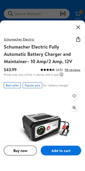

I have one I bought at Walmart, it charges and then will maintain,
45.00 or so (this is a newer model but the only different part is the sticker face)
