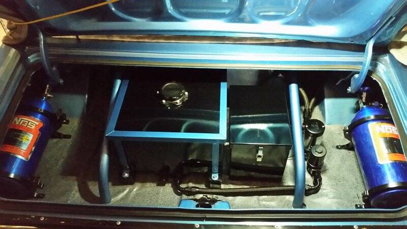

I have my battery relocated to the trunk in one of my cars. I have it grounded to the frame down through the trunk. Same as mentioned above. Frame rails tied, full cage, front and mid plates mounting engine.
That’s nice!!! Perfect thanks for photo I will try to duplicate. Answers my next question as to where to mount fuel pump. Where did you go though frame to cross under headers. I want to run next bay over just might have to drill a hole.
I ran the fuel line down the frame rails/frame ties, went through inner fender in engine bay to fuel log to regulators.
