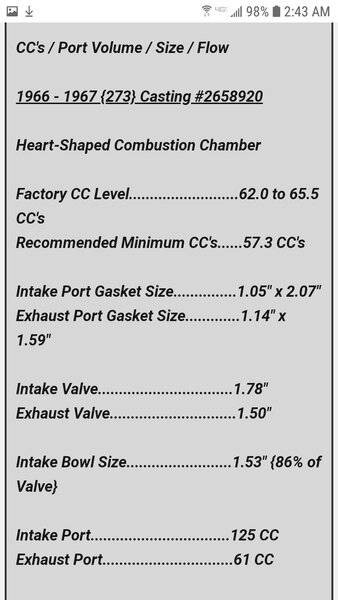

What are the two casting numbers for your heads now?

One head # 2658920
The other # 2853675

One head # 2658920
The other # 2853675
Here are specs on the 2 heads, the other # should probably be: 2843675
