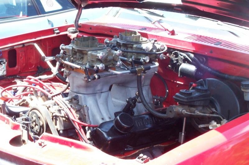

try 2 of the cheapo 600, 650, 700 or 750, vac carbs. the 600 and the 650's you can put on parallel to the t-ram (simple linkage) and the 700 and 750 have to go sideways.
