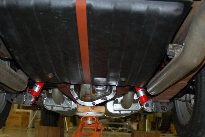

I used Koni shocks on my Duster for best performance, but it doesn't sound like that is what you need. Rock Auto probably has a decent selection of shocks at different price points so check them out.
hey andy, do you have a PN or source for the koni's? i was poking around the other day and couldn't find them for the life of me. thx!
Koni only lists their shocks for E body cars. Evidently the engineers who work at Koni are too stupid to understand that E body chassis parts commonly cross over to both A body and B body cars. You do have to know your cross over charts when ordering. And the rear Koni shocks don't actually fit any Mopar correctly because the lower eye is the wrong size. I make my own rear shock mount to solve that issue.
