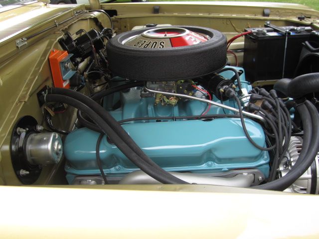

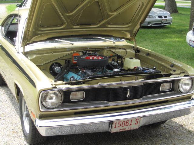

Here's friend Dan's '70 with a 383 on Schumacher mounts. This has a non-RPM Performer
which is a little shorter than the RPM version but there seems to be plenty of room.
Manifold height:
Performer RPM front 411/42, rear 511/42
vs.
Performer front 331/48, rear 411/44

............ I have did over 20 bb swaps, all with spool mounts.......only 3 had the per rpm intake......the low decks fit no problem, 1 had a 68 unsilenced air cleaner, 1 a dual snorkel, the other a440, needed a drop base chrome air cleaner.kim......
Thank you kim. So i should be ok with The rpm performer and a 3" drop base moroso air cleaner with a holley carb.
Basically what was stated is if you are running a lowdeck[383-400] you shouldnt have a problem,you usually only run into problems with hood clearance with the hi-deck[440 rb] with higher rise intakes as a general rule of thumb...my dart is 71 with /6 k-member and schumaker mounts with a 440 and I have problems with clearance and I do not like the dropdown aircleaner style bases which interferes with my set-up ,so I will build a ram-air set-up as I believe I posted on,also hood is a twin hoodscoop that will be funtionable,that is attached to the bottom side of hood and sets down on to the carb,so no hose/tubes for me that you see advertised in the 'ram air set-up'style breathers...so if you've ever seen a b-body ram-air set-up then you will know basically what I'm talking about...but all in all you should be just fine
