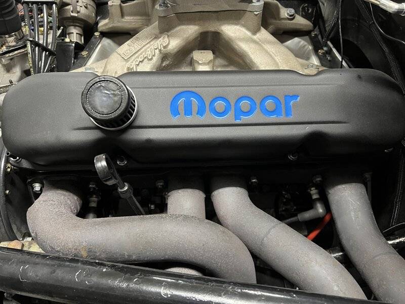

I have the Mopar Performance Black Wrinkle Cast Alum on my cars. There a tad heavy compared to the tin ones, but I have had no issues with them. Spend the extra money and get nice aluminum ones. These have thicker rails that will stay flat and will help with gasket leaks. Ever since switching to the Cast Alum ones I bought a set of Moroso Valve cover gaskets with the steel center and are reusable. Been on the car for many years without an issue and I usually check the valves once a year.

I run the MPP black cast aluminum. They seal well and look good too
