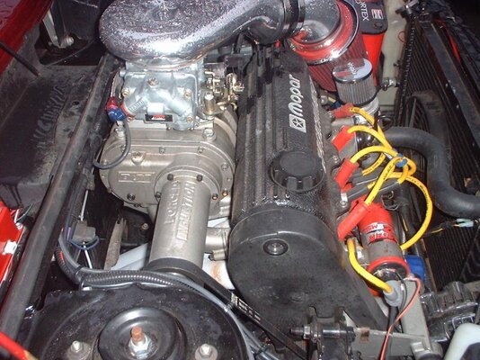

I ran a 600 on my 4 cyl Omni when I found the 500 holley was to small. Worked great on a 4 cyl.
