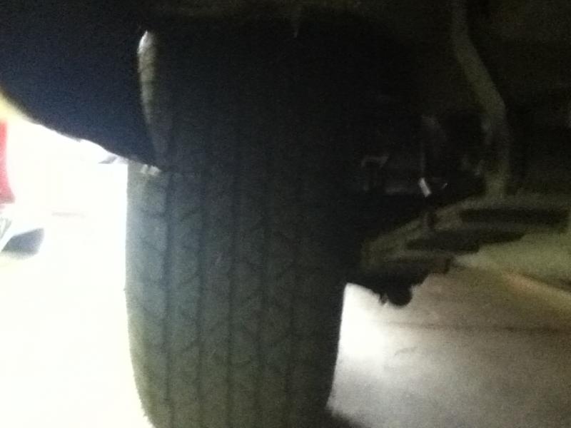

I have a Ferd Versaille disc brake axle, so the wheel offset is different than stock, but I rebuilt the springs using the original leaves and a spring pack from a junker Duster. I used (except for just one main) the longest leaves out of the two spring packs.
Wheels are Cherokee before they went to the "new" bolt pattern, tires are 225x75x15, and you couldn't get much taller in there. They all but hit the front of the bodywork, and DO rub on some very hard right turns

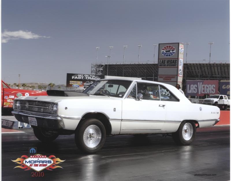

I'm running 255/60/15's drag radials on the back of my 68 Dart mounted on 15x7 with 4.5" backspaceing. No suspension or fender lip mods at all.
What tire and rim are running on the front??? Do you have any pictures???

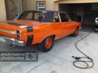

I had a 68 Dart GT with an 8 3/4 and a 15 x 7 Centerline wheel, but don't remember the offset, and had a 255 60 15 Mickey Thompson Drag radial on it and did not have a problem. Stock spring location with cal tracs split leafs and bars.

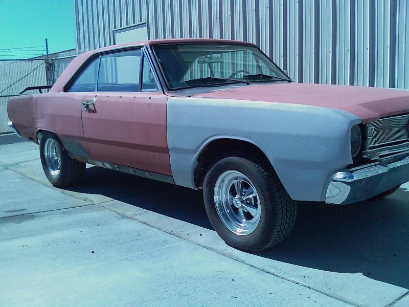

I see what you're saying, but custom BS is out of the question. I'm on a budget and have already decided to go with the wheels I've already got- 15 x 7 steelies.
One way to get a custom BS without buying custom made wheels is to purchase a wheel with too much BS then measure perfectly and get the exact size spacers needed. I'm doing that with my 69 Dart right now. I have SS springs and the offset shackle. I'm stuffing a 17x9 " Mustang Bullitt wheel in there with 275/40/17 rubber. The axle is also moved back to be centered in the wheel well so I'll run ~26" tire with no issues. Haven't finalized the spacer size needed, but I think the final BS for my particular setup will be about 4.75". Since I'm running a 17" whel and the 275 is on the smaller side to fit on a 9" rim I won't get much ballooning of the sidewall - which also helps with clearance.
