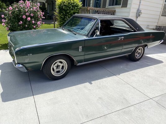

Cragar did make a 5 slot aluminum wheel ( not ss wheel) exactly as yours in small bolt not unilug but they are pretty scarce around here anyway.
See if anybody on abodies has any. They look like this on my buds small bolt dart.
Not unilug.

I have a set of those, they fit small bolt pattern. Came on a car I bought, would not run them. Not a fan of unilug.
Those ones in the #20 post are small bolt only, no unilug.
They will bolt on to 5x4” only.
Somewhat rare I’m told but I know 2 people here that have them on their sb darts.
I haven’t seen them otherwise.
Cragar apparently.
