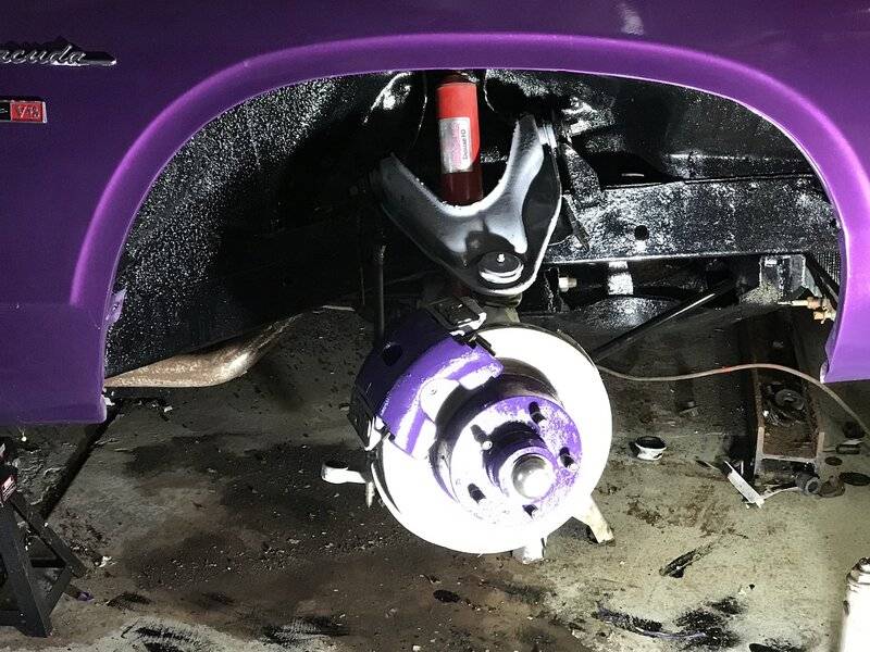

Dfr360cuda, what did you use for the undercoating?

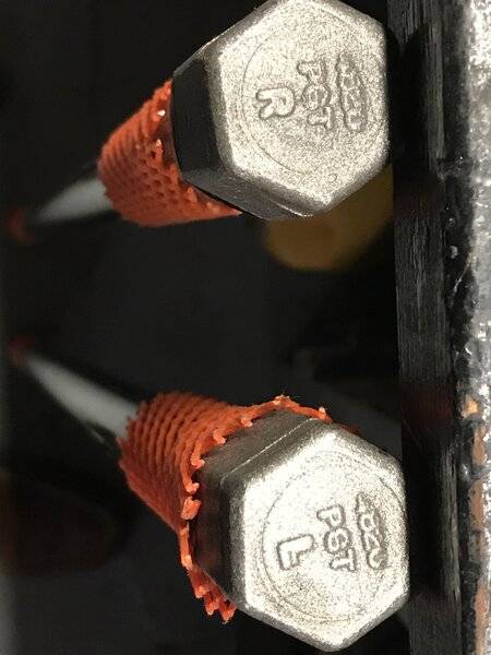

It's industrial paint. I can't remember the brand, I'll check tomorrow. I'm stalled now, I ripped a BJ boot, so I'm waiting on Amazon. I also got the PST 1.03's

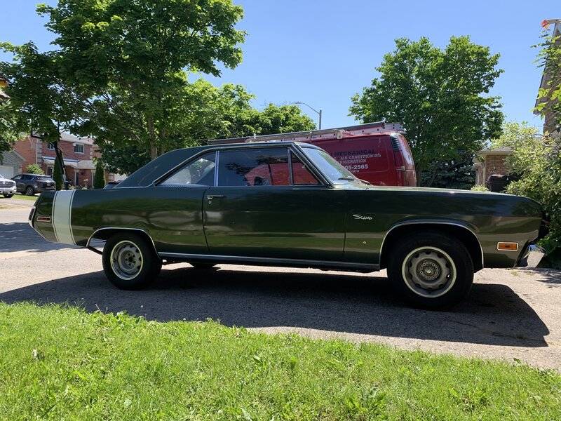

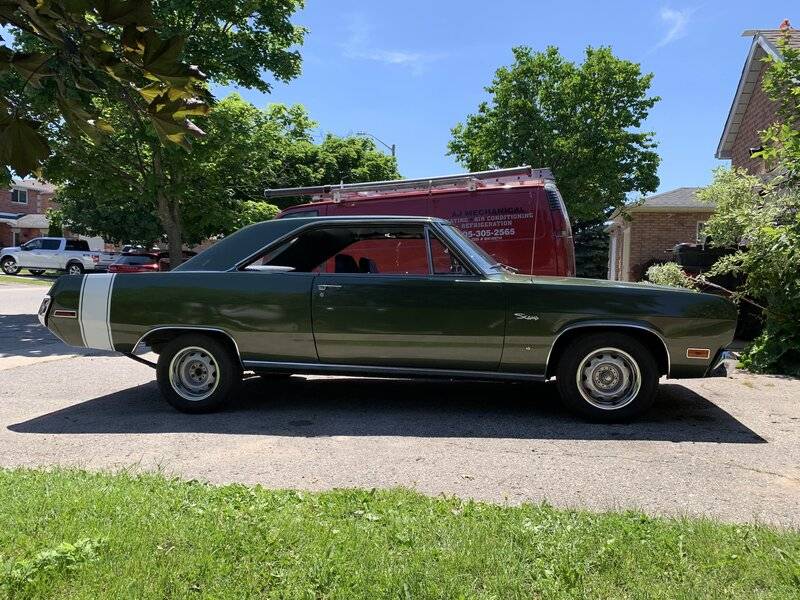

Adjusted the ride height today. About an inch to the bump stops. Not to bad. Still waiting on alignment. Still sits a bit high in the front. Maybe able to fill that with tire.

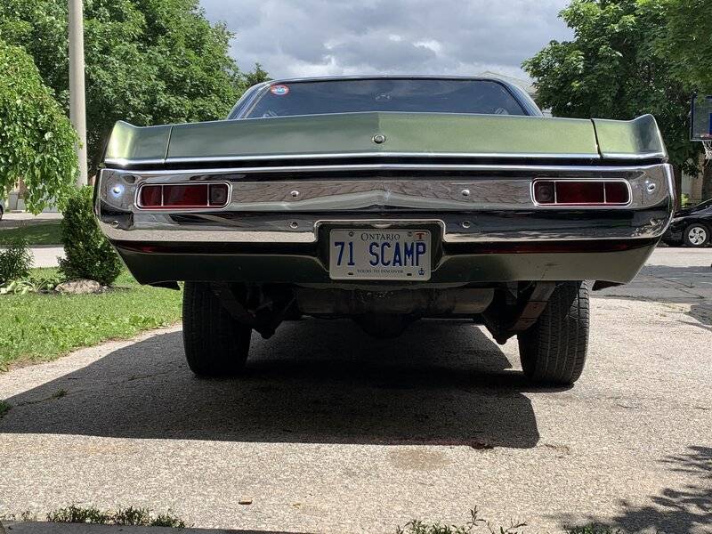

Before/After

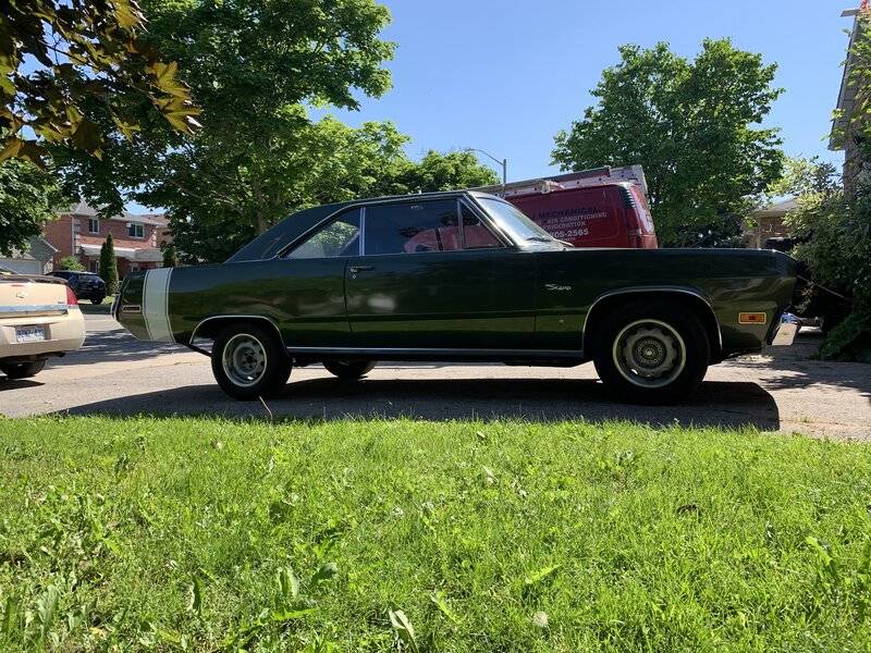

All done folks. Alignment complete. Rides nice and straight no play in the suspension. Brakes great. Steering box has a bit of wander and I’ll tackle that next.
