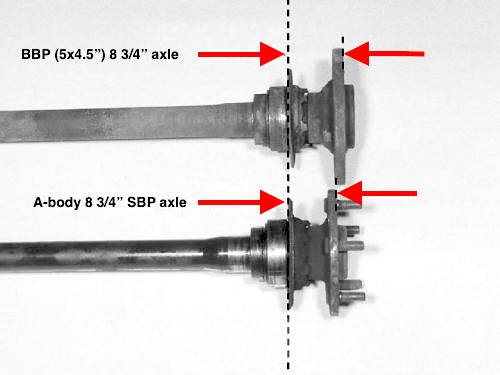

The 5x4.5” bolt pattern drums were 10x2.5”, and those axles use a different axle flange stand-off so the backing plate offset is different.
If you want to keep the 10x1.75” drums but use a 5x4.5” pattern you need to re-drill the stock SBP axles or buy axles that have the SBP axle flange offset and the drums must then be re-drilled for the 5x4.5” pattern.
Otherwise you need to use BBP axles with 10x2.5” drums and backing plates. No mixing and matching!
It all depends on how you go about changing the bolt pattern.
If you just redrill the stock axles, you need to redrill the stock drums, too. There's no 5x4.5 drum that will match your backing plates and have the correct center register.

If you are ordering aftermarket axles with the standard Mopar flange offset (not the A body offset), then any mid or full size Chrysler, some trucks and vans will have what you need, but you MUST use the matched backing plates. Period. There are no 5x4.5 drums that work with A body backing plates.

Then you will need to find 10x2.5" drums and backing plates, the 10x1.75" brakes will not fit those axles because they use the BBP flange offset.

All Mopar BBP axles use the same axle flange offset. You can pull 10x2.5" rear brakes off of ANY Mopar with a 5x4.5" pattern.
