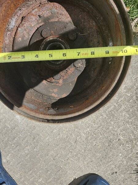

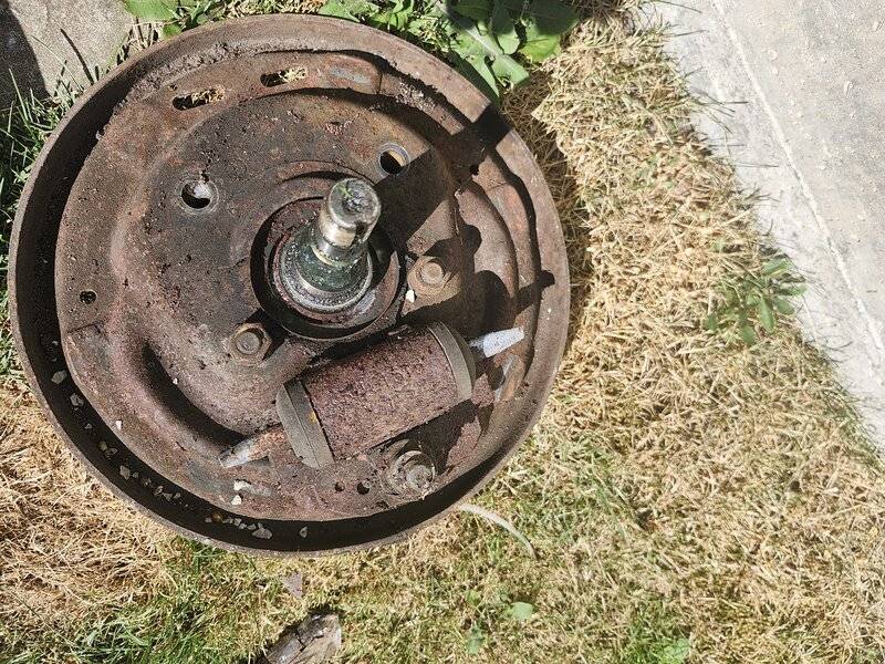

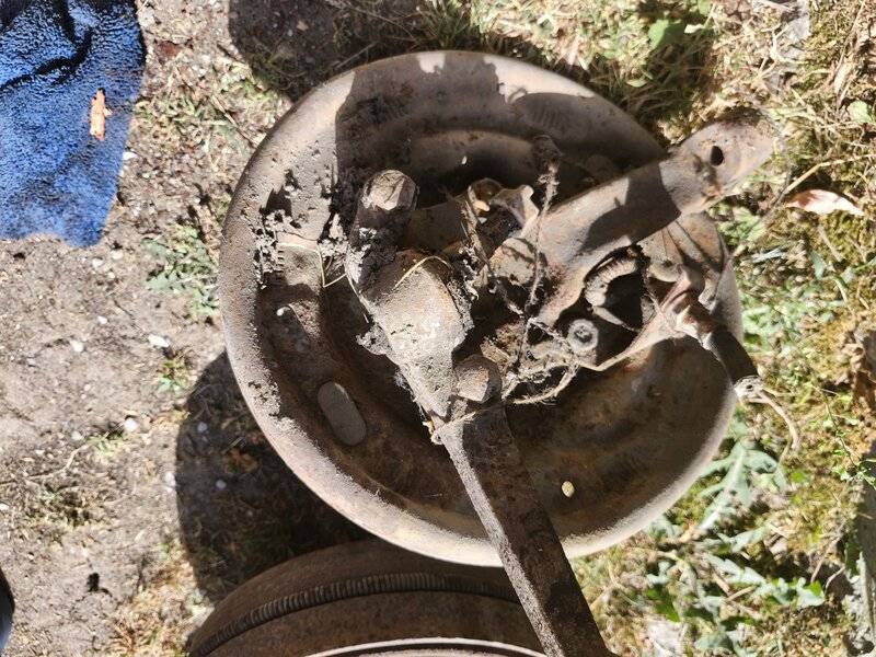

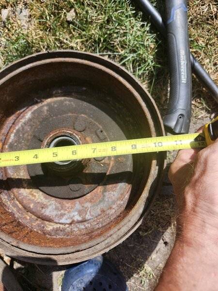

Hi all, these were on 69 cuda to roll around, marked as 70 val. They appear to be 10x 21/2. Is that correct? Any value in these?
I would assume backing plates won't interchange with rears? Trying to see if anything is worth keeping for our 67 which is a factory disc/drum car.
Thanks,
Steve
as far as for your car, no. nothing there you really need.
but the hubs are for sure worth keeping and selling. somebody could use those.
the attaching hardware, hose bracket and the knuckle have some value.
Yep, hubs are getting very scarce, - just sold my last set of hubs, damaged beyond repair by hammering out the studs without removing the swage, or drilling the stud head off, and punching the remainder of stud out the front.
Save them, - they may save a car .
Thanks guys, what kinda value? I have UCA's and LCA(no tabs)as well Planning on taking as much as I can to Moparfest. And hopefully come back empty.
Thanks
If the drums are still standard size, they will probably clean up with machining. Most drums will overbore at least 0.060", & I think they would clean up with a lot less; so might be of interest to those who do not want to buy Chinese drums....
