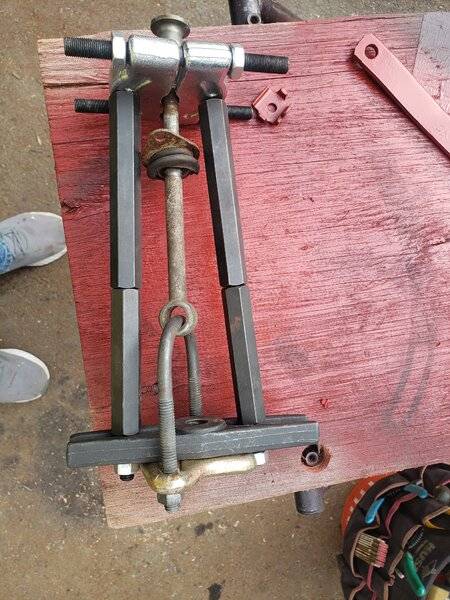

Ok so I do have the snap ring. How do you remove the rod from the old piston? I gave it a few light pulls but I don't want to force anything. Pictures appear that it just pushes into the new piston.

Ordinarily I'd say Step-by-step is here, but it looks like you've, ah, already done quite a bit of disassembly. You're doing to have to resort to more violent methods (or do some quick-and-sloppy reassembly and work forward from there according to the link).
You may need to re-use the rubber retainer bushing, so mete out your violence on the pushrod with care.

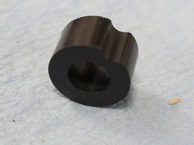

Lucky you salvaged the rubber bushing which locks the brake rod in the MC piston. I did a test fit with a new bushing once, then had to remove the rod (to slip on the dust boot) and tore up the new bushing getting it out. I bought them from a brake vendor (Dr Diff?). My 1964 Valiant is manual drum brakes, but I changed to a dual MC, using an aluminum 2-bolt one for a 1999 Breeze ABS ($25 new) with a 2-4 adapter plate ($30 ebay). The brake rod fit and the pedal wound up in the same place. I glued a dust boot to the MC to be safe.
