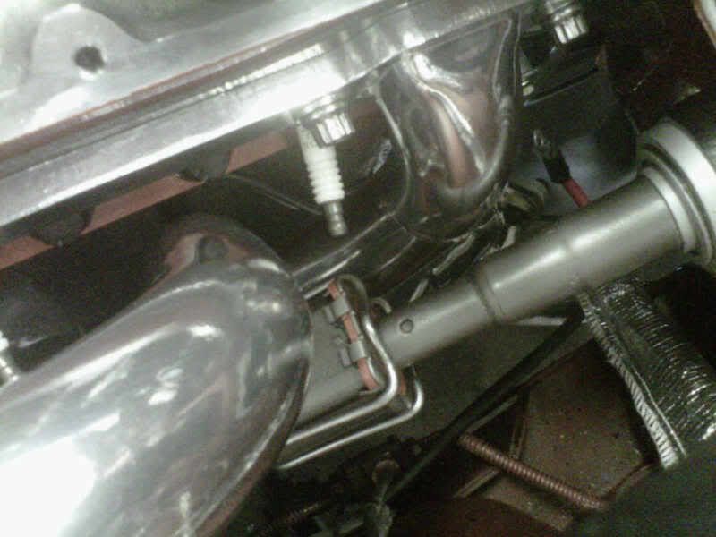

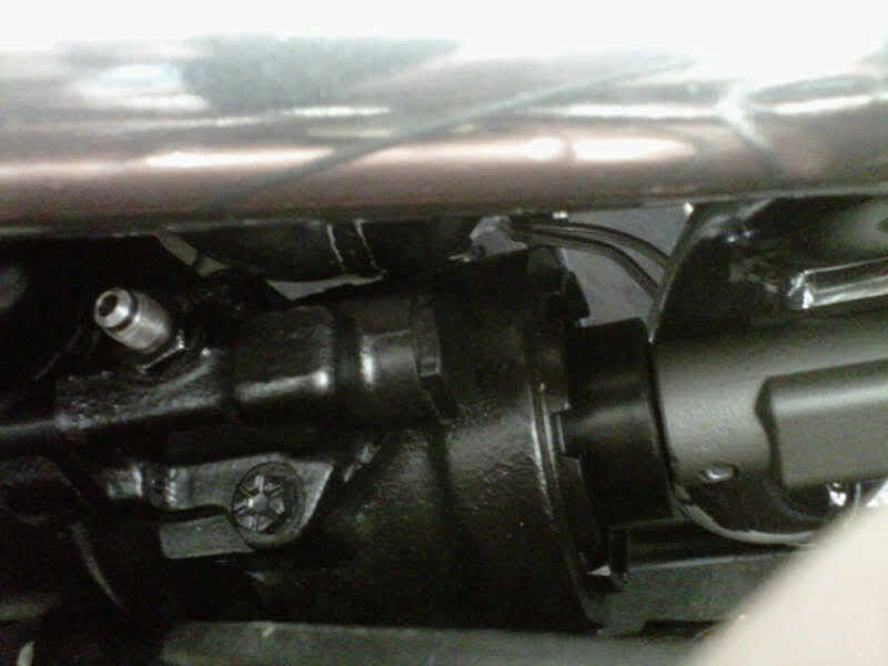

I'm 16 and I got a duster for 2500 of my own cash. But mine had a mean small block. Personally id got with a small block jus for the ease of installation. I have a 440 out of an old truck but I can't have powersteering without serious mods. If you have the resources go for it dude! But for 5k you can have a wicked small block
Sure you can with Shumachers motor mounts and their TRY-Y headers....
tricky with column shift....
close with power steering....

It can be done. There are other options then Schumacher headers though. I dont like the idea of building my motor only to choke it down with 1 5/8 headers tubes. Look in to some good used partial fenderwell headers I got mine used for $75.
