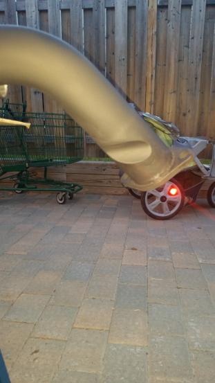

Well I got the exhaust all welded up and installed. I had to do some custom work to the drivers side headpipe for torsion bar clearance. I now have 1/2" gap between bar and pipe.. should be good??
Nice job! While it's off the car, you may want to test it with air or water to see if there are any pin holes.
You'll never notice that dimple btw. Nice work.
