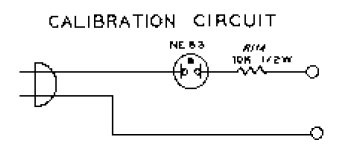

The old Knight Kit/ Heathkit tachs calibrated right off line voltage with this:
The problem is, 60 hz AC generates a very low RPM, 900? I believe for a V8
(60HZ X 60 seconds in a minute / 4 because a V8 fires 4x per crank revolution)
Full wave rectify it to get 120Hz for 1800 RPM. Danger !!! That circuit is line powered, isolation transformer and fuse advised.
I thought of that, but 1800 still doesn't give one a very comprehensive idea of how linear the meter is
