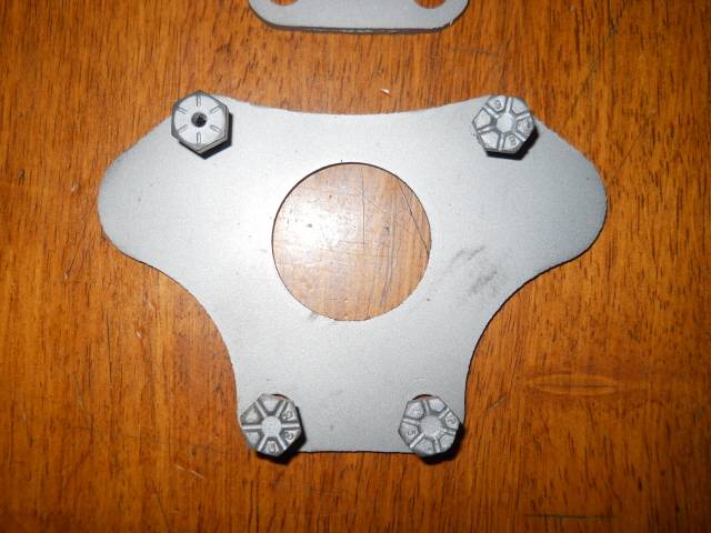

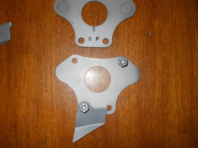

Leave the bolt out. Usually I only use 2 bolts upper drivers or left, and the lower passenger or right. Here is a picture of the bolts in the plate. First picture is the old way not recommended anymore. The second picture is the new way with the dripper installed. It will drain oil better without the bolt with the hole. . Not all plates have the notch in them pictured in the top plate of the second picture. This notch helps oil the cam face. Something you may want to consider doing
So, it's now recommended to cut a notch in a factory plate for that extra oiling?
