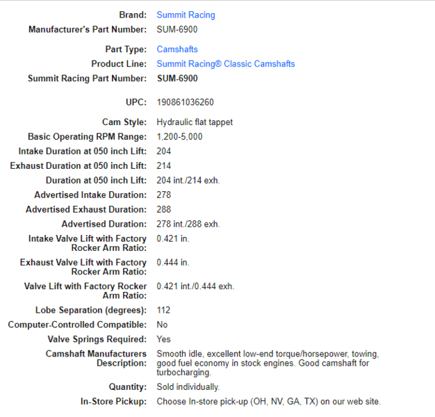

Again, a lot of great information. Thank you all! Will have to go back to the drawing board and decide where to go from here. At this time we will probably throw back together. That being said, will it at least be able to cruise around in? forgot to mention that the current cam is a summit 6900.

Thats the really old school "204-214" cam spit out on the automated camgrinders by the thousands
lots of private labels as Summit and Edelbrock
sorta looks like the 340 cam but it's not- it's worse
the 278-288 is at .004 whereas the 340 cam is at around .008 so do not compare durations
you can compare the .204 and lift to the cams in the 340 list I posted
