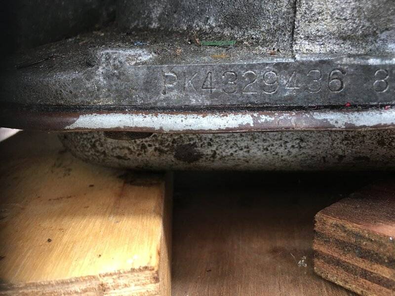

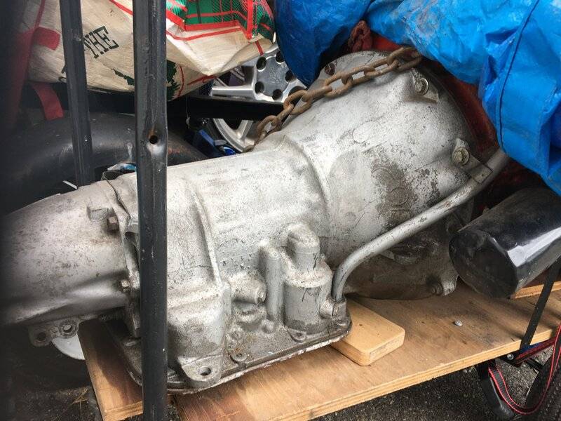

Can anyone help identify transmission?
71_Duster
Member

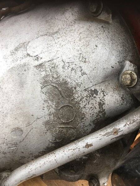

I believe it’s a 904?

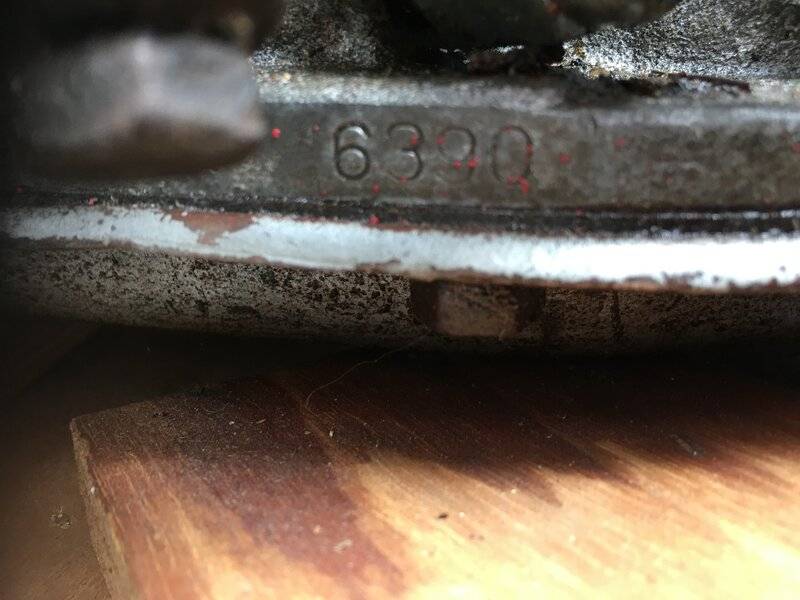

I have the serial number by shift selector if it helps but can’t identify numbers
Date code is January 20, 1984.
4329436:
999 transmission found in Gran Fury, Fifth Avenue and Diplomat with 318 engine, 2.6 axle ratio and it's a lock-up.
4329436:
Wow, that’s more than I could ask. Thank you. I’m guessing it’s just the same as a 904 except it has a lock up?
Most definitely an A999. Mine is from a 1989 Dodge Diplomat that I found chucked into the back of an old panel van in a salvage yard.
These are damned good transmissions. Stronger than the A904, then you got the 2.74/1.54 1st/2nd gears and then lock-up. Which reduces your RPM's by 150-200 when cruising on the highway/freeway.
