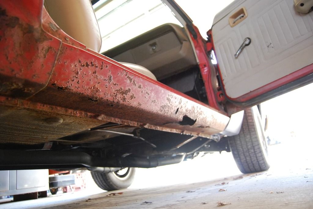

Sure, my project started out as repairing my passenger side rocker panel... one thing led to another and I ended up cutting the side of the car off... Hopefully my pics will help! I highly recomend AMD Sheet metal!

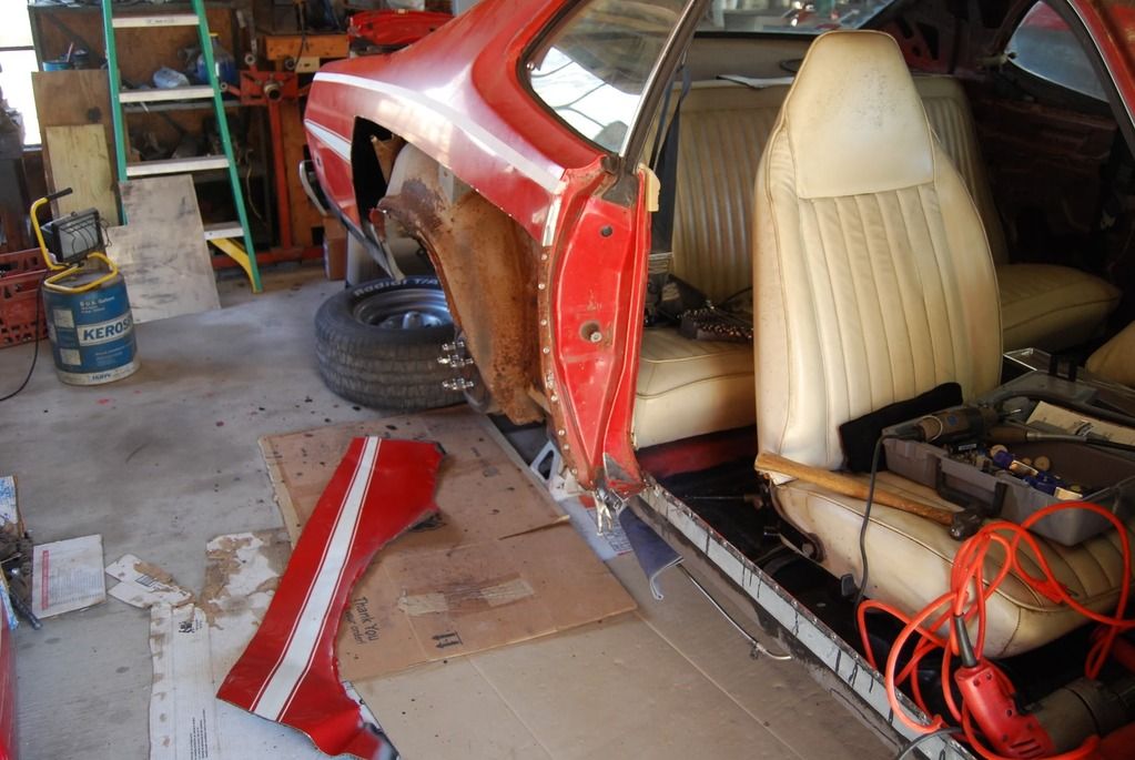

In this one the rocker panel is cut off and I am working on the cutting the quarter off. I used the new quarter as a templete. The tape is there to keep me from cutting too much off.

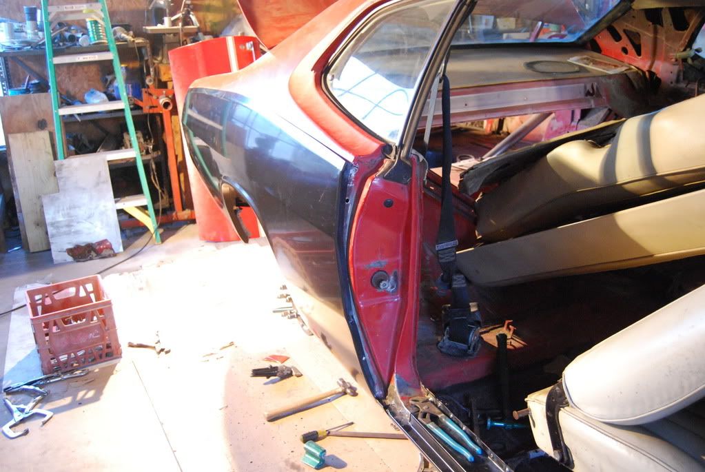

I found that my outer wheel house was pretty ate up with rust. Also the dill-hole who had the car before me did a nice hack job to the rear seat belt mount... have to fix that too.

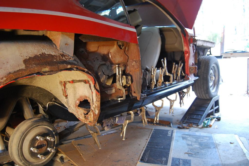

The new AMD Rocker panel
Fixing the wheel house
New wheel house sectioned on to the old one
Here is the new quarter panel, double checking the wheel house before it is welded in place.

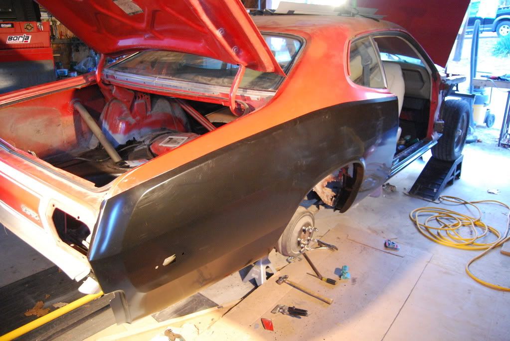

Here it is, pretty much as it sits now. I am finishing the work on the driver side door. The new quarter panel is not going to take very much work (hopefully) to smooth out and hide the weld.
I am not very good at body work, it takes me a very long time (or I am very slow at it)... Either way, I hope this helps!

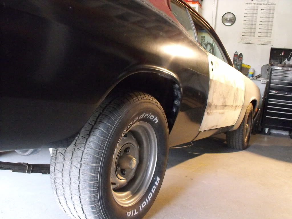

Here is a slightly different approach. This is an old Goodmark skin and it didn't fit very well at the door jamb and at the back so we spliced it in differently than the previous poster. We also went below the bodyline.
We also replaced the trunk extension and the complete outer wheel house. The extension took some massaging as it was an older one (can't remember where I got it) but the outer wheelhouse was an AMD unit and a very nice part.

I went over the welds with a coat of Duraglass, knocked that down with a grinder, then gave it a skim coat or 2 of regular filler, which I sanded with 80 grit and finished up with 220.

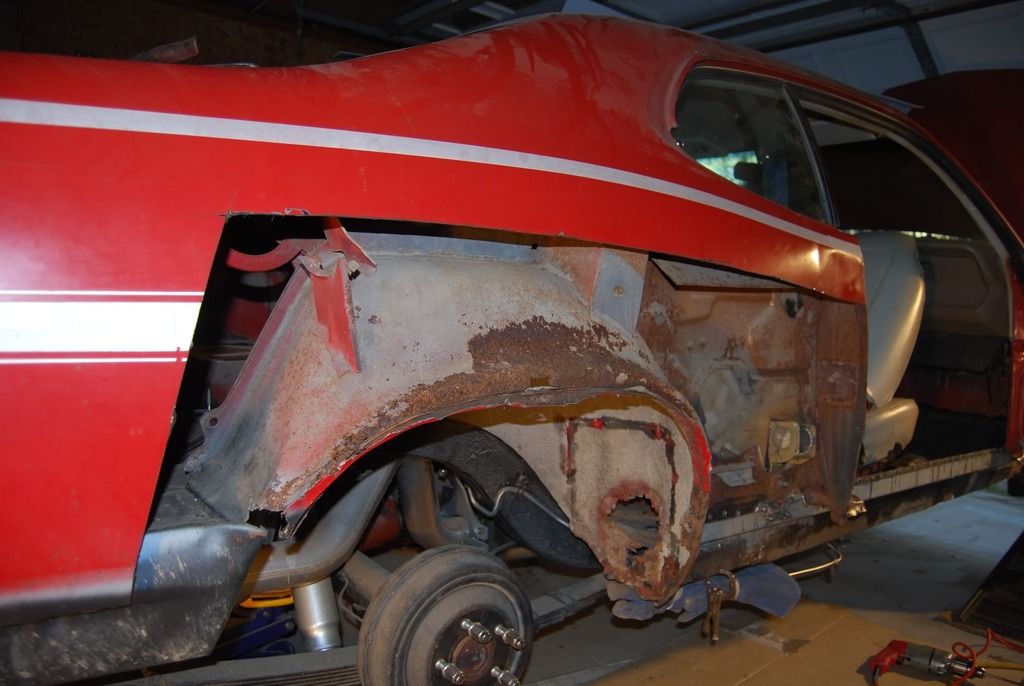

yeh those photos make sence to me, thing is i dont have any quarter panel behind the tail panel, as you can see from the pic.. so i am thinking i have to somehow make the groove in the quarter. sorry im a noob :p hehe
