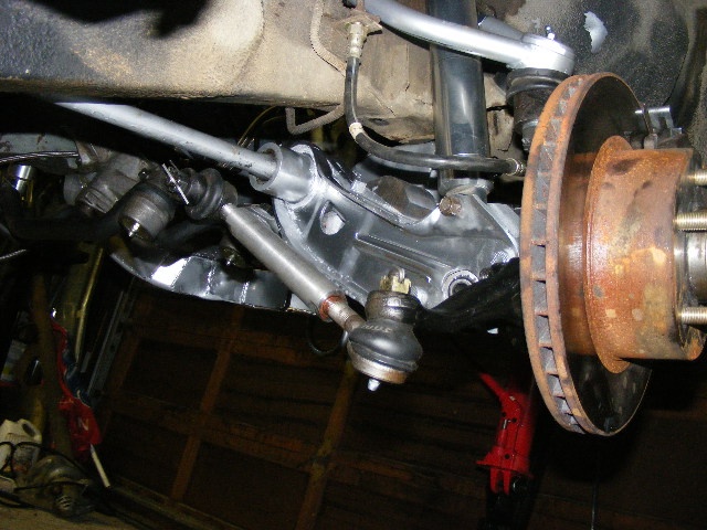

I have lcas out of 73 duster along with brake set up.I was wondering if i can use the lcas from the 73 in my 65 valiant.I understand they are the same length in all abodys? but with the early a bodys is this a problem? i want to put the new lca bushings in 73 lca now so it will be quick for the disc brake swap. :happy1: thanks in advance for advice! If they wont work i will just use my 65 lcas thanks.:burnout:

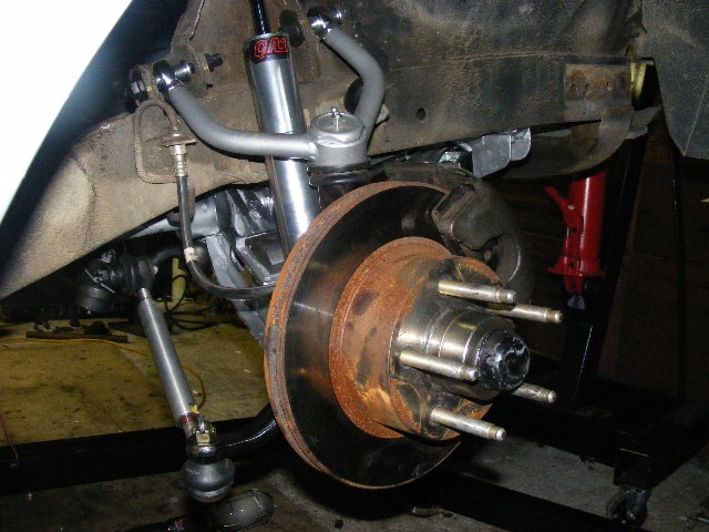

:glasses7: I have rms adjustable ucas with heim joints ends.Those are going in with new 1"tbars,lower ball joints moog,new uca ball joints,idler arm,strut rod bushings,brake lines. lca moog bushings Thank you for clearing that up for me!:prayer::prayer: starting conversion today.:blob: thanks for your time .have a great day.
:happy1:Nice setup qa1 shocks heavy duty tie rods nice! Only reason i was asking is i have the 73lca in a box an want to put in the bushings n clean them up n paint them for quick install so it will save me the time instead of using mine that are on the car now.just pull mine off and put the 73 lcas that i will prep first with paint n bushings first.:blob: Your 66 looks great with your mods! thats what i am doing to mine cant wait!:burnout: Thanks for your time and your pics . have a good day now.:glasses7:
