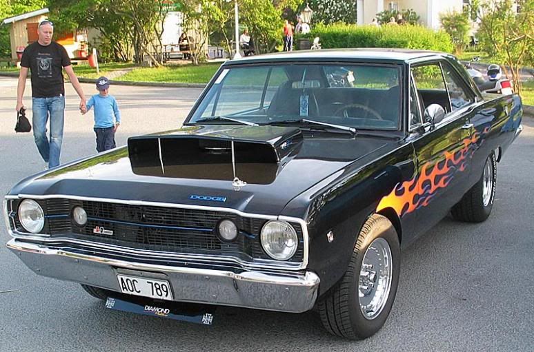

If your having problems at speed try this....RR_Sweden gave me the info for front air chin spoiler..
His....
Mine...
