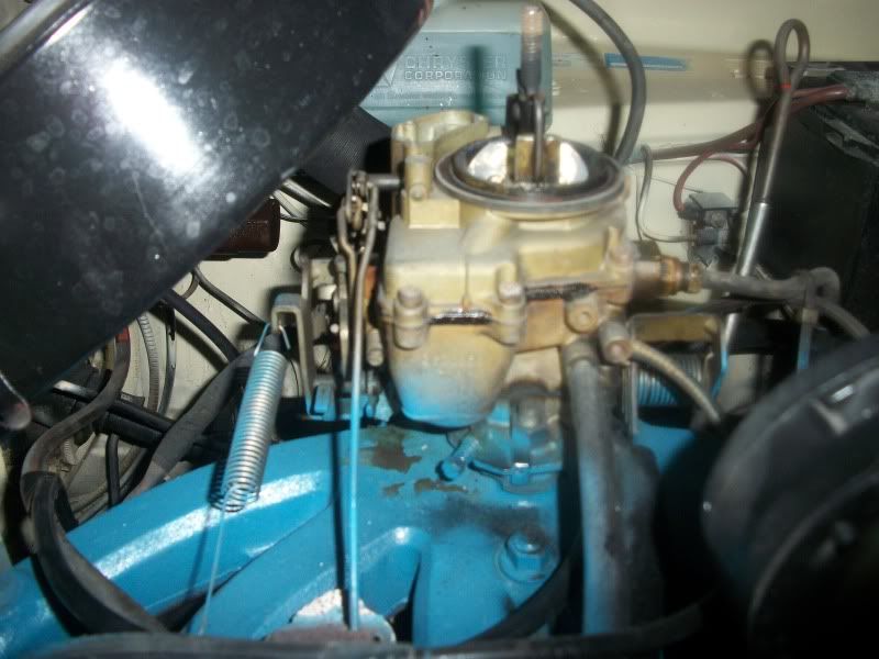

I will try to get some pictures up. Thank you for your info! This car is actually a San Diego car. It was owned by a Marine Officer who was stationed there and that is where it spent its whole life until my dad bought it a few years ago.

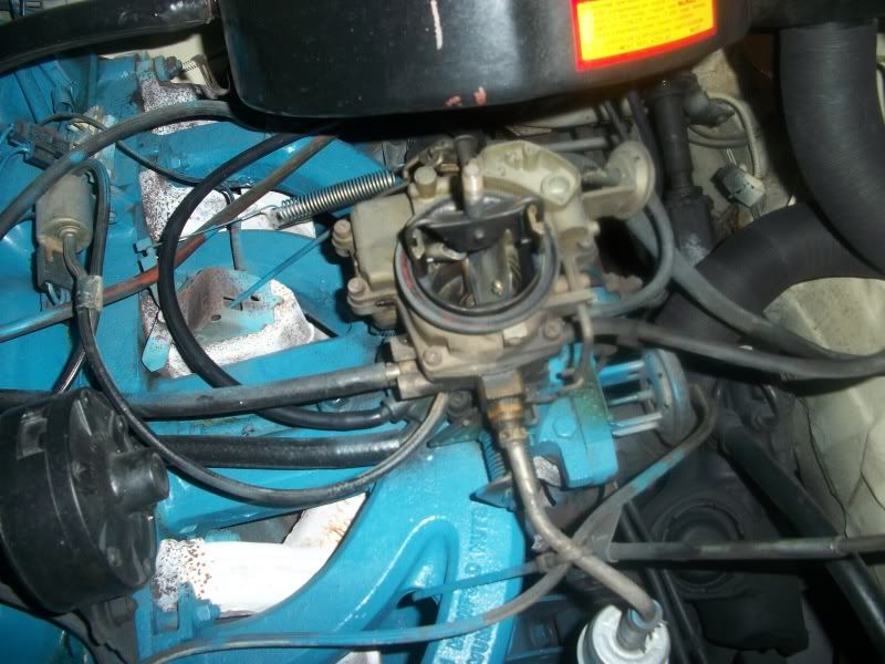

This car you've pictured has not got a Super Six (which came with a Carter BBD only; the article stating a 2280 was factory equipment is in error. Holley sold 2280s as aftermarket replacements for the BBD, and the 2280 was factory installed on some V8s.). Your car has a Holley 1945 1bbl carburetor. The list number (and the factory service number) are stamped on the side surface visible in your second-to-last photo. It looks as if someone's gotten a little carried away with a can of Chrysler Blue spray engine paint.

As I was looking at the 1945 I noticed that there is a hose attachment on the carbs left side, towards the top. Why would mine not have one? is mine just an earlier style?
Here is a pic of the carb with the hose attachment in question. You can see it on the carbs top right as it curves around towards the front of the carb.

They made the 1945 for many years and since there were different smog requirements for each, they have various features. A '64 Valiant wouldn't have had a "Super Six" from the factory either. '77 was the first year for the 6cyl. 2bbl setup. What he probably had was a "Super 225" which was the standard 1bbl 225 that year.

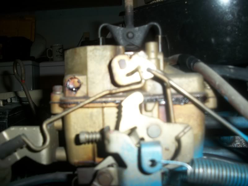

As for your choke problem, unless something is broken or bent beyond repair, the choke looks good in your photos. Open the throttle a little and make sure everything moves freely and that when it's cold, the choke is completely closes and once the engine starts the choke pull-off opens the choke about 1/8-1/4". You'll have to look up your exact carb to see what the factory setting is but that should be pretty close. If the choke doesn't open at all, it will run real rich and belch black smoke out the exhaust. That is usually caused by the choke pull-off diaphram having a hole in it. It's not repairable so you'll have to get a new one. In some cases, the linkage could be way out of adjustment, broken, or missing but your photos show that they're present and connected. If the choke opens too much, it will run too lean and will probably die when you put it in gear or try to accelerate. Yours is the heat assist type so like I said before, check that the heater element is working. Just turn the key to the on position and put your finger on the choke housing. It should heat up fairly quickly so carefull you don't burn your finger! If the car runs good once it's fully warmed up, it should be in the choke adjustment and/or components.
If the choke opens too much, it will run too lean and will probably die when you put it in gear or try to accelerate. If the car runs good once it's fully warmed up, it should be in the choke adjustment and/or components.
