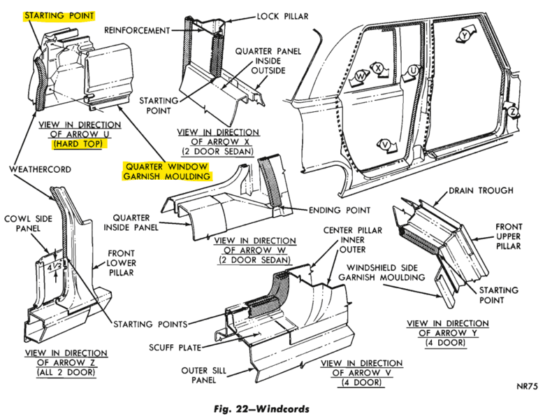

How much of the windlace goes under the sill plate? I have new windlace and it runs about 3-4 inches on the pinchweld under the sill plate.
Maybe that's your problem. From what I recall it goes under there about 1 1/2 inches and it is narrowed where it slips under the plate
Thanks this helps immensely. I did figure out that the windlace goes under the upper panel. I guess that I should have taken more notes and pictures 7 years ago when I tore it down lol
I think the carpet goes over the pinch weld and is cut off so that it bumps up against the wind lace under the sill plate. That way you have a clean transition between the carpet and the wind lace under the sill plate. That's the way I did mine at least.
