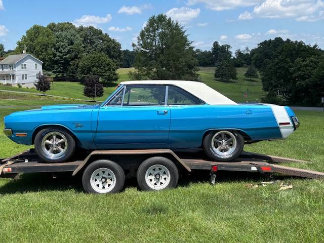

New vinyl top and headliner are installed. The installer left the headliner extra long at the front and wrapped it around and the pinch weld and held it in place with multiple clips for transport on my open trailer. So, I'll definitely need to trim this back before installing the windshield rubber. Can anybody give me a clue or photo that shows how far to cut it back?

Sorry - I found the answer in a better search. It looks like it needs to be trimmed back just far enough so it does not get under the rubber at the pinch weld and interfere with the seal. The teeth will still grip the headliner fabric and the rubber flap inside will cover the teeth and serve as interior trim.
