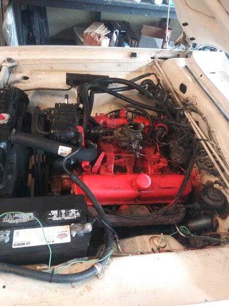

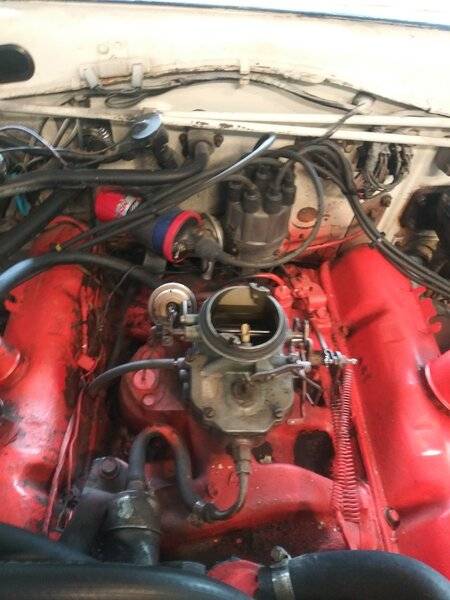

Well I think I found the problem; the carburetor. With the car cold, took the air cleaner off, and the top choke plate was open / in a near vertical position. Pulled on the accelerator linkage, and the plate closed / horizontal. Tried staring the car, and it would not. Pressed on the accelerator pedal once, tried starting again, and it started.

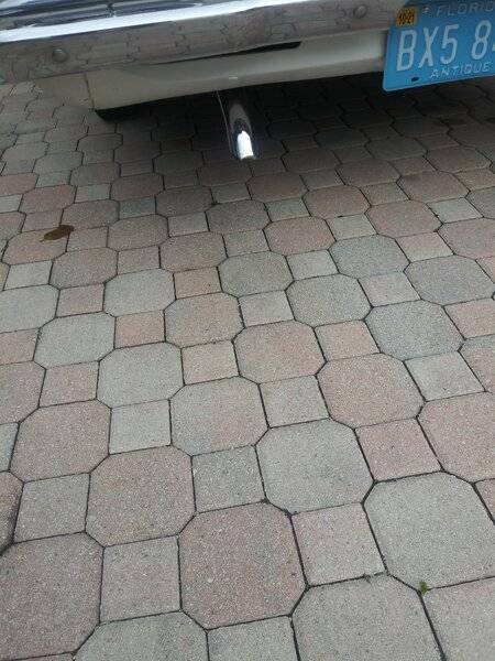

Left the car idling, and took the attached pics; no smoking. Drove the car around the block, but without pressing the accelerator pedal, the car was happily cruising along at 20 mph. Had to stomp pedal to slow the revs down. Also noticed signs of leakage from the carb down to the intake manifold.
So how easy is it to rebuild these 2 barrel carbs? What's the best place to get a rebuild kit? What type of carb is this?
Those are pretty simple carbs I believe it is a Carter. Make sure the choke pull off is working. Should pull the plunger back and hold it there after it starts. Also it is responsible for pulling the choke open a little after it starts. My guess is it is going to need adjusting
Also since you admit being green when it comes to carbs. If you can get someone with carburetor knowledge to help and teach you. I would advise doing that.
What causes the choke pull off to operate, engine vacuum?
