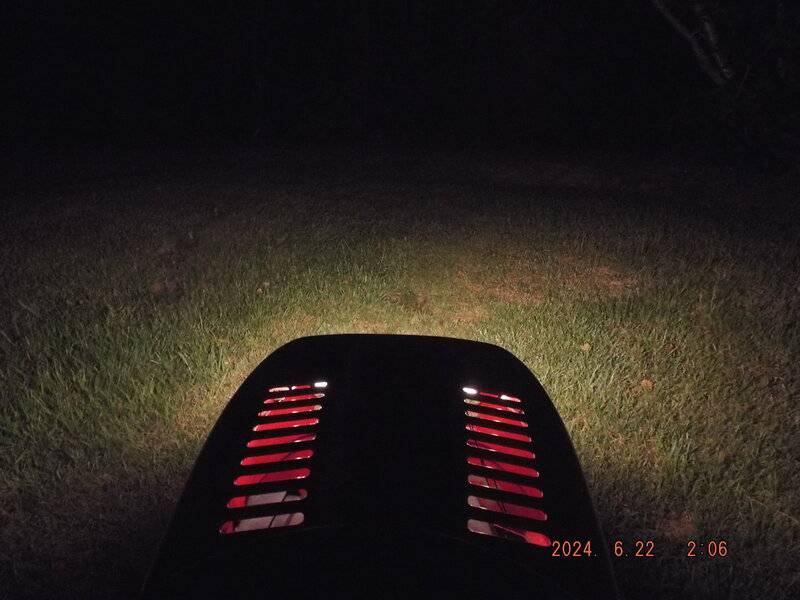

I remember seeing in another thread @slantsixdan talkin about painting the inside of light fixtures like tail lights and turn signal housings with ceiling white paint. I just happen to have a quart of ceiling white paint, because I'm working on the house. I've been doing some work on one of my lawn mowers and decided to try it. Now keep in mind, these are "only" standard el cheapo 1156 bulbs. I am absolutely floored. I'll probably never mow in the dark, but I sure could now. I just like everything to work as good as it can. Check it out. Vixen and Gladys are next. Thanks, Dan!
Yupper. Not for optical-type lamps where you need a specular/mirrorlike reflector to form the beam, but the 'headlamps' on a mower are really more like back-up lights on a car. The dude in this movie takes awhile to get to the point, but he eventually (3:24) he starts to get around to it, and the difference is pretty obvious even with a low-quality camera. And he just used regular white, not ceiling white; regular white looks dishwater-grey next to ceiling white.

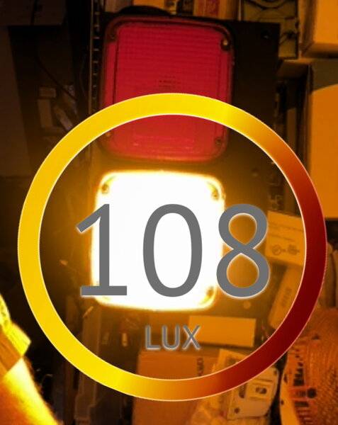

I finally got some get-to-the-point pics with a new utility truck taillight assembly. Takes an 1157 in the brake/tail light, and 1156 in the turn signal. The reflector bowls were factory-painted matte chrome silver, very similar to the reflector material in our cars.
Here's the taillight assembly as made, with the silvery reflectors:
And after I painted the reflectors white:
Here are the reflectors after I applied Behr Ultra Pure White, which has a reflectivity value of 94, even higher than the Sherwin-Williams stuff. I used a foam brush to apply it. It goes on thick, and took 2 coats for full visual coverage:

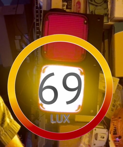

I used a luxmeter app on my phone to record the tail, brake, and turn signal output with the stock reflectors, then with the white reflectors. Same bulbs on the same power supply at the same distance.
Tail, stock reflector and then white reflector:
Brake, stock reflector and then white reflector:
Turn signal, stock reflector and then white reflector:
This isn't a calibrated luxmeter setup, so while the readings are valid (~ish) for more/less comparison, they aren't valid on their own to determine exactly how much light the lamps were putting out.
For fun, I put the best-so-far of the "LED bulbs" suitable for this kind of lamp, in the turn signal with the white reflector:
Yeah, lookit that: less light than the stock bulb in the stock reflector. Pffft.
