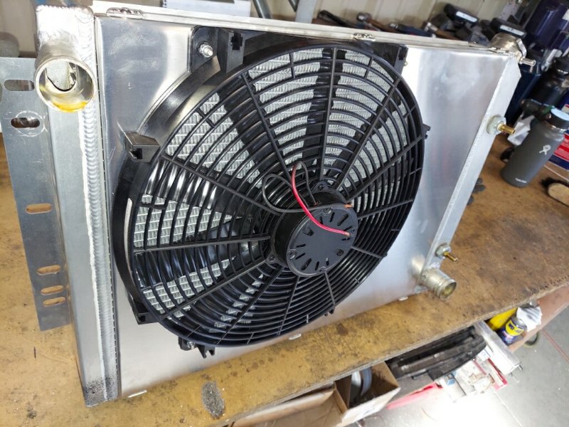

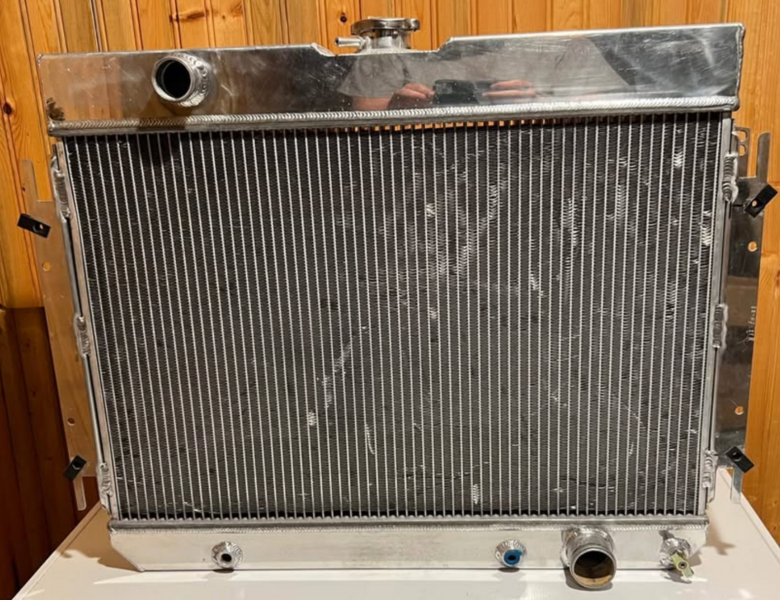

I need a 26" radiator for my new motor (460+hp) in a 73 Cuda and ran across a barely used Champion CC281B for a Chevy Impala application that is priced right. I will obviously need to figure out if it can be made to fit the opening, but I'm more worried about the cooling capacity and looking for feedback from experience with a similar model from Champion. Specs are below but short story is that it is advertised for up to 650hp and is a three row with .75" tubes. Is that 650hp rating reliable with a proper shroud and fan package? I thought I read a while back that 1" two rows were more efficient, but I can't find that reference any longer. Car will be used on the street a lot and road racing/Auto-x so cooling capacity is important.

One 16" or two 12" Electric fans recommended for this core size (sold separately)
The radiators that are supposed to fit, don't. You really want to buy that? The Champion 26" in my Road Runner, supposed to fit, doesn't, had to modify it. I didn't buy it, came with the car. So my vote is certainly a NO.

I have a new aluminum Mancini E-body radiator with a two 1" tube core. But the core is 22" wide x18 1/8" tall and I doubt I'm anywhere close to a Champion radiator.
