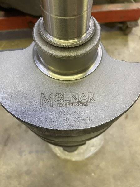

Well I got jumpy a few weeks ago when I talked to Ed at Molnar and they only had two sets of 6.125 Chevy sized rods so I ordered a set. The Chevy sized 340 cranks won’t be in till after May sometime at the earliest. Well now that I’m feeling better I tore my 422 apart and low and behold the assembly is Mopar sized including a .984 piston pin. So I called about a Mopar journal 340 based crank and they have the cranks but not the rods. Lol. But the rods are in the United States so they should have them soon and do what they do ASAP. The crank is being shipped this week so I will have to use the rods on a new set of Diamond Pistons I have on my shelf and get a Chevy sized crank to build another 408 in the future. I can’t wait till these shipping delays are over.

Well I ordered it Tuesday morning and it arrived at 1:45 Thursday. Can’t beat that.
