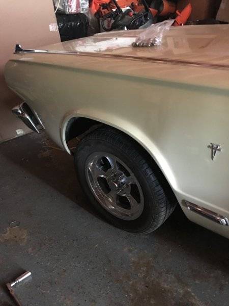

I bought a 65 dart convert a couple of yrs ago. When it got delivered I drove it down my driveway and I knew immediately that some freakin yo-yo put solid mounts in it. I have a few things to address to get it on the road. Motor mounts are on my list. I just put a new set of wheels on it.
