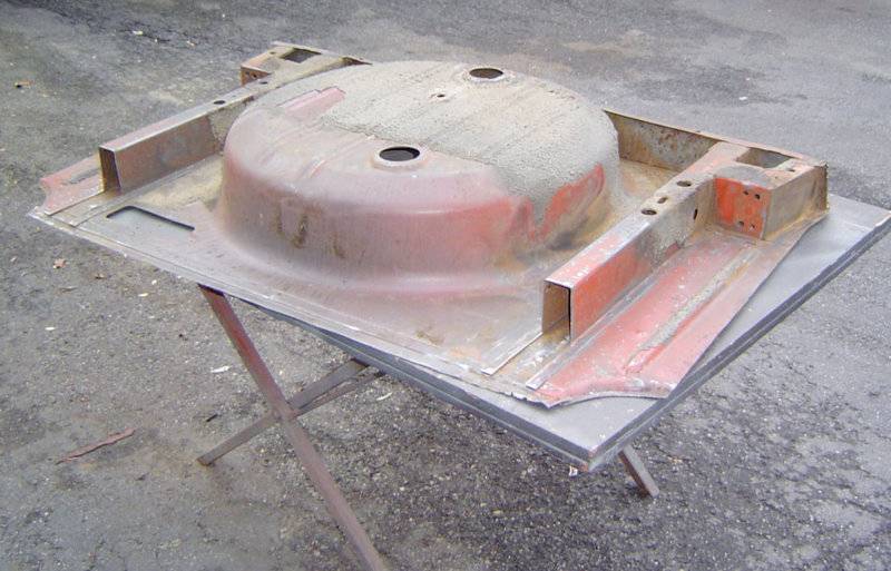

This is how I did the spare tire well in my 65 valiant wagon. The rear part of the frame was toast so when I remover the good well from the parts car I kept the frame on it and fitted it to the good part of the wagons frame .Did that close to 20 years ago and it is still solid as a rock .
Thats really a good idea. Rails on this one are solid though so i wont splice.

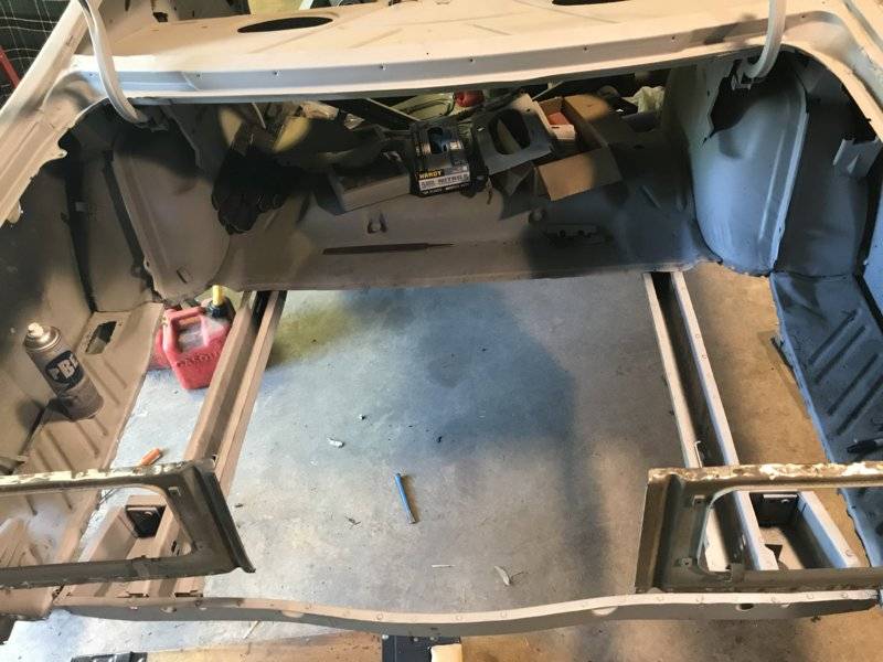

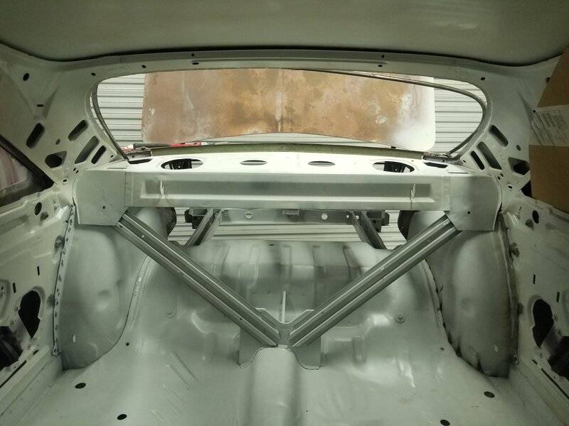

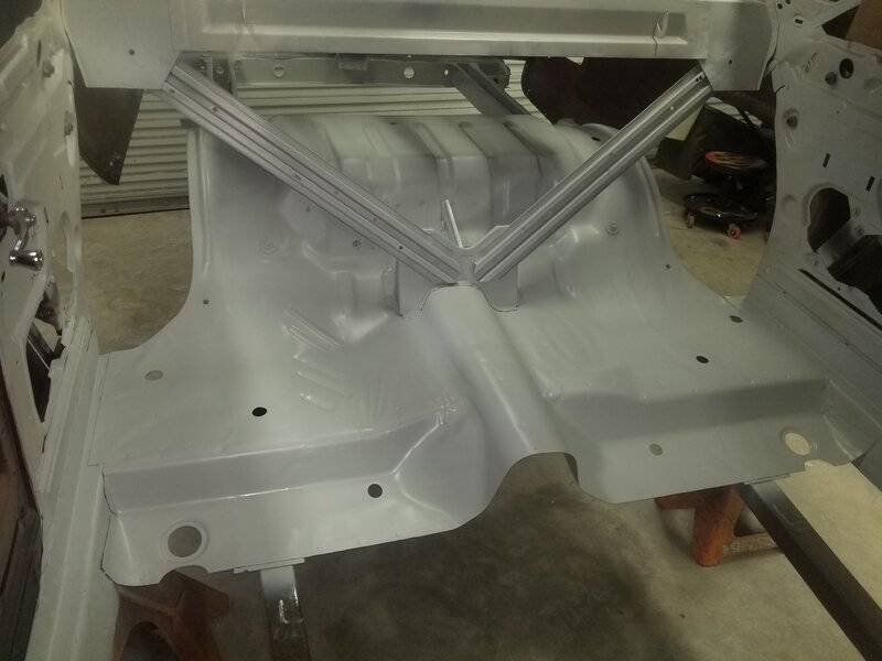

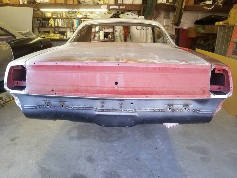

Here’s where I’m at on my 70 duster fortunately everything but the pan was solid
Maybe it will fit into the trunk opening and i can push it forward, set rhe back end in place and it will set down in place.

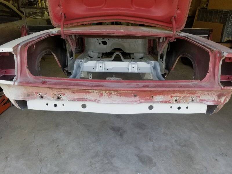

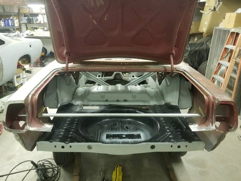

Got outer wheel houses and trunk drops from AMD. Stripping down a rust free 71 halfascamp. Went in halvsies on it. Using its transition pan, trunk pan, and inner wheel houses. Buddy of mine, another fabo member got all the outer body sheetmetal. Roof, dutchman, quarters for his 72 scamp. Scamper as it sits now. Got a rust free spare tire well from another fabo member to fix the old scamper one.
Damn. Old thread. I ended up changing whole trunk pan with a new repop. I sandblasted and epoxy primered the insides of the framerails before doing the sheetmetal work. Time consuming but worth it.
