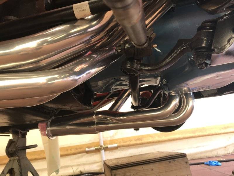

there's a couple things that concern me on the stainless steel ones and both have to do with where they seal it against the head. One they seemed a little big without much surface between the actual opening and the bolt like I showed in the picture? Also I don't see where they kind of weld bead around each flange for sealing purposes? And I'm feeling if they come off of eBay that my recourse will be much lower than Jegs..
yeah, I don't know how to advise you on that. I would say, at 177 bucks you don't have a lot to lose....
Yeah I'm kind of at a toss-up right now. At the hundred and seventy-seven I have no recourse and not a good feeling about them sealing whatsoever.. for another $70 I could get the ceramic coated ones for a little under 250 from Jegs and be able to have a little recourse and a more comfortable feeling that they're going to have that bead that goes around and seals...
