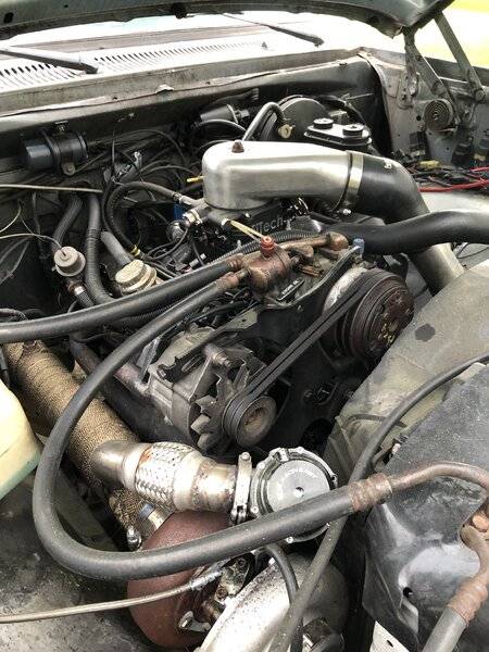

Did the 318 turbo last year. Had maybe $1000 into it. You will need some form of rising rate fuel regulator and pump.the pic was after I added the fitech which I wouldn’t recommend.
