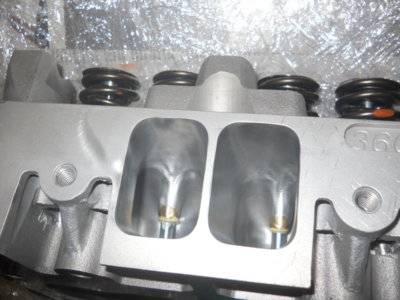

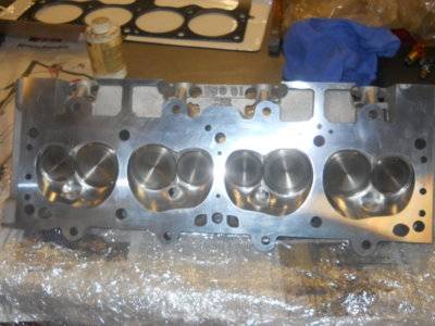

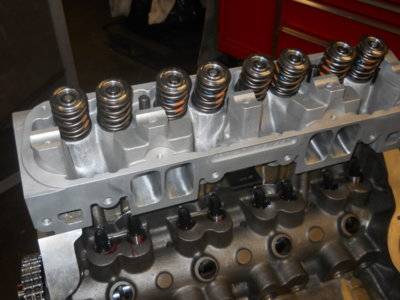

here are my heads before and the after the cleaner
This was after cleaning
And yes those are all the same parts including the valves
