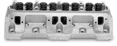

doing a refresh on my 416 after my 2nd set or 1008's gave up. had the heads (edlebrock) and block resurfaced. so I'm going with cometics this time my question is the felpros have a bore size of 4.125 the cometic's come in various bore sizes. I'm at .030 os which is 4.070. the cometics come in 4.080 and 4.125 bore size so the question is will the 4.080's work or should I go with the 4.125's.
