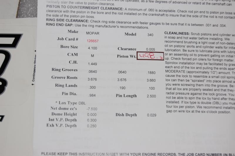

Comp Ratio someone confirm my numbers please
Sorry, but this is incorrect. Look at this calculator.
http://www.kb-silvolite.com/calc.php?action=piston
See where it says "Note: A piston with a positive number is either a flat-top with valve reliefs or a dish. A piston with a negative number is a pop-up."
The reason for this is because of what I stated the first time. A domed piston has a negative cc measurement since it takes away from the combustion area. A flat or dished piston has a positive number because it adds to the combustion area. It's just that simple.
If you read my entire post you would have seen where i said to enter the number the way the calculator tells you too. The one I use states to enter a dish or valve reliefs as a negative number. It's just matter of how the formula in the program is constructed. One isn't correct and one wrong as long as they give you the correct answer.
I understand that......and I wasn't tryin to argue....what I was trying to figure out is, if the two ways are BOTH correct, why are they coming up with two entierly different compression ratios? I guess I shouldda included all that, too. LOL sorry bout that. SUMTHIN has gotta be wrong somewhere. whether it's the caulculator, us humans enterin info backwards or sumthin.
So, if I run felpro 1008 .039 gasket deck at .010 that should put me at 11.2:1 and a quench at .049 correct? oh yeah, there is a very slight dish.
NO INCORRECT. You said you have heads with a full cut chamber that is .060" deep. THEREFORE YOU CANNOT HAVE ANY USABLE QUENCH EFFECT WITH ANY GASKET.
I capitalized because you seem to be looking past that fact. You have to cut the heads to get the quench area or the chamber to have any effect, and that will put your chamber size down to 59ccs...
Don't know why the two calculators are constructed that way. The one I used (http://www.csgnetwork.com/compcalc.html) could have been as simple as a dome is plus because it adds materials to the piston where a dish is negative because it subtracts material. Where the KB calculator is looking at it from the cylinder standpoint; a dome is negative because it subtracts chamber volume where a dish is positive because it adds to the chamber volume.
To write the formulas either way is a simple algebra manipulation. Remember (+3) times (+2) = (+6) and (-3) times (-2) = (+6). So just have the right signs in the equation in the right place will make either give you the correct answer.
If you understand what you are calculating and the calcultor does not state how to enter numbers you will knwo from looking at them which is correct.
