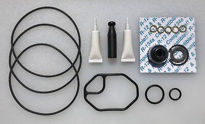

Reseal kit available...I guess thats all it takes if its not grenaded. Took me a while to find out the Lexus part number is a 10PA20C series. I got a lot of green dye by the manifold and connectors.
