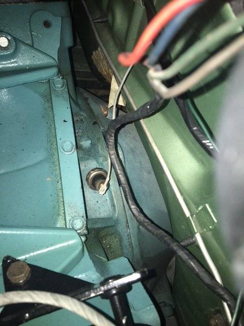

I had to have my tach retired to accept an electronic ignition. Wiring on the old console tachs were pretty complicated. Guy in Seattle did mine. Do you have a gray wire coming off the firewall?
Yes.....it goes to what looks like some kind of sending unit just in front of the bell housing...see attached.
@Eddie348 knows a little about this issue< I can't remember what he said the fix was, but maybe he can stop in here and help...
