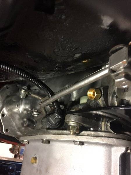

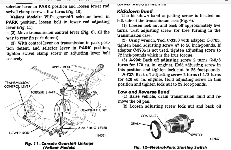

Does someone have a picture of the lower rod for a console shifter. I thought I had one but mine may actually be another front rod, fml. I have the FSM and here is the reference picture of what I'm looking for a picture of and what I think I may have.

here's the 68' plymouth book. don't know if it helps. if everything else is in place, and you put the trans and shifter in park, you should be able to make a rod the goes from "A" to "B"
My problem is my rod I think. My insert points are 90 degrees off and the picture you posted it looks like they should be 180 degrees off. The FSM picture I posted looks like it should be a straight through insert point on the lower rod.

Yep I think that's the correct one and my rod is incorrect. Damn that stinks. I have a swivel assembly and it definitely does not function properly. Now I guess I'll have to hunt down another rod... and rehook up my column for a touch longer.
That drawing shows adjusting lever? in place of the typical adjusting block. I dont recall ever seeing that setup.
The typical rod with a flat on it for the typical adjusting blocks' screw to land on isn't so hard to make ( done it ) if you have a donor rod that already has the correct close bend end with cotter pin hole. That OEM rod was drill rod hard though. Torch required to bend it.
All you would need sent to you is a piece of coat hanger bent to correct shape with tape or other marking of length of the adjusting flat.
me neither. i've never had a console car, just 4 speeds and column shifts
