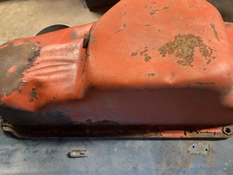

How do I identify the correct oil pan for my '65 Formula S and '65 Signet convertible? I notice some oil pans have factory 3 digit numbers on the sump. Do all factory Mopar oil sumps have a number like that? I have a couple of "394" oil pans here in storage. I know from experience the steering link bangs into some oil pans at full turns on the 1965 models. What we need to answer the question once and for all is to find someone with both a "394" pan and a factory original '65 273 oil pan for direct comparison. Thank you.

I don't have 394 pan, have 65 273 pan. Can take pics if that would help.
Try to get the same angle as in post #1 and we can compare! (The surface rust actually helps determine where the dents and divots are in the photos)

Looks pretty close. Mine has that dent in the side. I don;t remember what for though.

I don't see any obvious differences between the "394" and the unmarked 273 oil pan. I guess the clearance notches for the steering link are not the same right and left, one side being more severe because the motor sits offset toward the passenger side as factory installed. Both "notches" look about the same to me.
