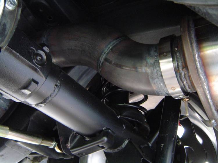

Good day fellow enthusiasts! ! ! I hope all's well as can be with you cool cats out there ! ! ! I have a question about a Weld line that I honestly believe is a SERIOUS hookup from Moser Engineering in this Narrowing job.......background, Axle Housing (8.75) was exactly 59.125 Outer axle housing flange to outer axle housing flange when I sent it in....
M.E. called when they received the Housing to confirm what was being done to it.....spoke to the actual Tech that was doing the work.....this is all after an email correspondence with an Advisor from M.E....everything was ultra smooth.....now, as I figured it, about 3.230? Or something, can't remember, would be taken out of each side and using the original ends....that was done, and the Welds are awesome.....but there's a curious weld line on one side of the axle that I THINK might be due to straightening the housing ? Any welders out there or others that might like to give a gander as to what this additional weld line is about ? I'm not upset about the job.....I think it was an awesome job and I am BEYOND satisfied mates ! ! ! I just wonder what that other line might be about.....anyways, pics or it didn't happen right ? Check the one side up near the center section ......a hook up in straightening the housing maybe ?
And here's the business.....I'm no welder but these look LEGIT to me......next up, the one side with an additional weld line....now, keep in mind, originally the end of the housing to the original spring perches were like 4" away before (it was I that removed the perches and ground down the remaining weld....yikes), and you'll see how they are now brought in to normal a Body width. I can see the ends were brought in, but how about the other weld line ?
And here's the pic to check out in detail....
On one side of the housing there's one weld line between the housing end and the remaining housing length....on the other side is the same thing, but there's another line up near the center ...any guesses ?
Some people narrow the housing by removing a section closer to the housing. It appears they shortened the tube there and welded new ends on. Ugly where the perch was IMO. He also could have been trying to keep the old perch location the same distance from the drum and had to shorten that tube to get your measurement

It always helps to Know people. Getting info and going back and looking at your pictures . Take a close look at your second picture in post #2. Tells the whole story why they cut the tube. How about a picture of the complete housing.
Everyone makes mistakes . But they should not have let this go out the door. Their claim the housing was bad? Why didn't they see that and call you before they did anything. Not only did the new guy weld the end on offset. Do you think it could have been clocked wrong? The weld is not evenly tied into the axle end. The new guy Fuuged up and you paid ror it.

Good day fellow enthusiasts ! ! ! I wanted to drop an update regarding that Weld Line I've been most curious about......I did get in touch with Moser and they were able to have the actual Tech that worked on the Housing explain the Weld up near the Center Section, and rather than paraphrase, I'll just paste the exact reply.....
D***** this is S****
Sometime when a housing is bent so bad that the housing end would fall off center from the tube so far it wouldn’t work out so we slit the tube and pull it where it needs to be to be strait. Also, for brackets lining up as well wheel base and such. Does that answer your question? Thank you
That's the explanation directly from Moser......Im still on the fence about it....I was offered an another Housing at a neighborhood friendly price if I want to exercise that option so I don't know.....still thinking about it.....I've only read of 2 breaks along Weld Lines that Moser performed a narrowing job on over the last 13 Years and they were both more race circuit cars, so I don't know.....out of all of this, my Wife came up with the best line of reasoning that I've taken from this experience which may mean a "go ahead" to get a new housing and that was, "well - if you're worried about that part breaking under stress, shouldn't you be equally as worried about those other 2 parts possibly breaking ? Just go with one that's not ever been fixed.... that's easy....., you don't need me to tell you that" ! ! !
So yeah, I'll take that as permission to go with the offer for a new Housing......but will I ? ? I'm still on the fence about it honestly.....
The welded on flanges at the end have much less leverage . Also why is the end off center if they straightened the housing before putting the ends on?
They will never admit what they did or why they did it if they screwed up. The main thing is they didn't contact you and tell you that your housing was bent. They are saying its their way or the highway. They should have given you the opportunity to send them another housing. You didn't ask them to repair your housing you asked them to narrow it. But this would have shown the housing was straight to start with.
Looking at your pictures the end is still welded on offset. So didn't they straighten it enough? Or did they slice it so they didn't have to cut the end back off that was welded on wrong? I would never trust them now. we have housings A,B,C and E. And many of them . Not a one bent one in the house. You just so happened to buy the rare bent housing to narrow. Cut me a break.. You Pm'd me and I gave you our number to call. You didn't.
I under stand your frustration and don't want to accept that you got had. Some of these places have reps that could sell ice to an Eskimo.
Like if you would send a block here for a .030 bore and a tool would break boring it. Then I would tell you we had to sleeve it because it was cracked. But it was magnafluxed and pressure tested before any machine work was done. I hope you were wearing boots when the gave you that line of bullshit.
THEY SHOULD HAVE CONTACTED YOU BEFORE ANY WORK WAS DONE IF IT WAS BENT. Now your stuck with your thumbs up you *** and the only proof you have is the end is still off center. I wouldn't accept that weld on my Housing no matter what their excuse is. I am so glad you posted this. they just lost me as a customer. I'll never buy anything Moser again for any customer. They should admit they were wrong. even if it is for not contacting you and refund you money.
