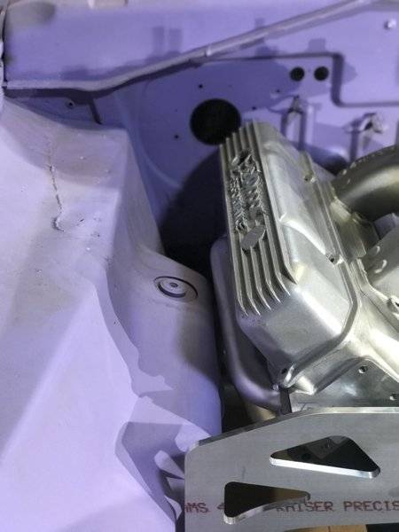

Yes your wrong and yes it was and is a *****. They're installed but with everything on this Dart RB nothing is easy. Im using a soft faced mallet and using a sharpie have shaped the tubes on drivers side to give a RCH on my manual steering gear and torsion bar also the inside for tail end of starter housing. My passenger side is hitting 2 runners on torsion bar but it sits in there but tighter than I thought. There was no returning as you gotta start somewhere. My issue at this point is pass side tubes not allowing engine to sit up off fender well. To get these in I removed string column and moved manual master cylinder off to the side. Also had a not so good pick using engine hoist and tilting engine. Northern California is smoking hot now so swimming more wrenching less. Heres some pics so it's real if it's in pics right haha.
Tubes look bigger than 2'' in the pics !

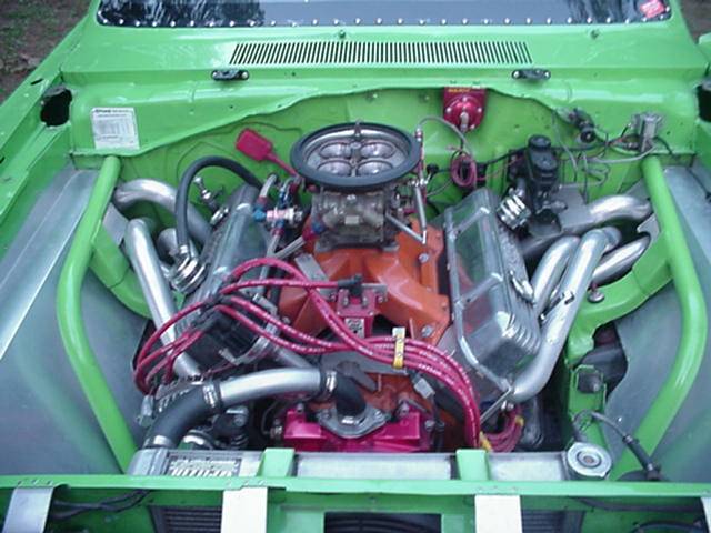

I heard someone say once, "When you stuff a motor in a car that it was never designed for, you know who makes headers for it? You do!"
I hit the disagree button , my tti headers dont and havent hit anything, even w/ a 440 block and raised port heads , just gotta get the front end way up in the air to take off or install them , way up , and work the starter at the same time !
So for you guys using the TTIs are you bolting them to the motor and dropping it in? Or can you actually install them with the motor in place?
I think these are TTI headers. I’ve never had a set till now as they came with this car. One of these days maybe it will actually run. Lol
