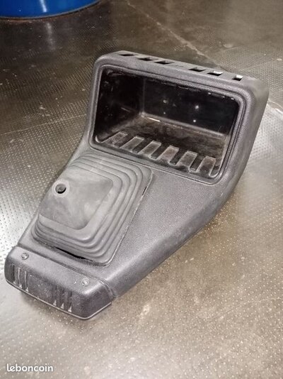

I was looking for a short console, compatible with the offset gear lever. Not easy.

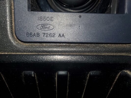

Finally I found a guy who sold this kind of console. Unknown origin, Ford for sure but undetermined model. Escort maybe?
It wasn't very clean and desirable... but cheap (10 euros) :)

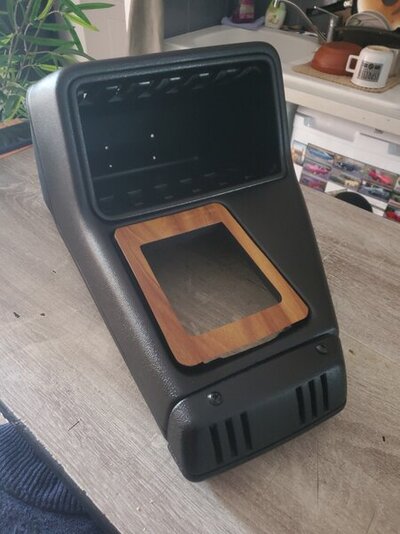

When i received it, I tested the fitment and yes... the overall size and the offset were compatible with my gear lever.
I just had to remove the rubber boot, but I kept the frame.
A good cleaning, two layers of satin black paint and a little sheet of self-adhesive false wood

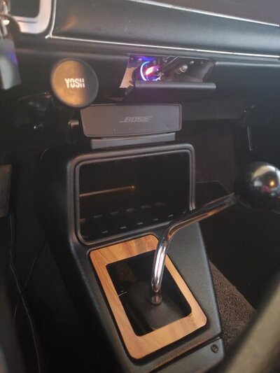

In the car, with my Bose bluetooth speaker :
Not yet permanently installed, it will be fixed with self-adhesive Velcro on the carpet.
I also have to install the Bose USB charging dock into the console

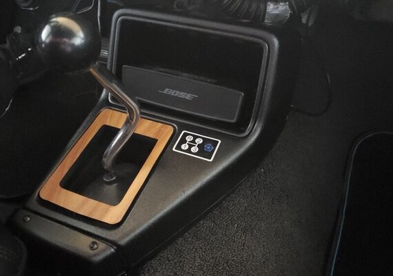

In the end, it will look like this :

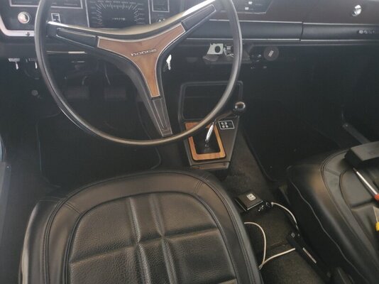

Good coincidence you answer to my thread, today I completed the installation
Bose USB charger dock installed and powered by the cigar lighter, just like the phone.
Wires are routed behing the ashtray.
"YOSH" is the magnetic phone holder (a suction cup under the dash)
