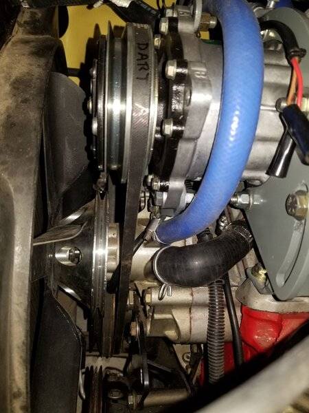

Brackets I made for my Sanden on my 408 Magnum. Brackets started out from a mid-eighties truck small block.
Installed running engine with Holley Sniper EFI.
Looks good. Taking a Magnum back in time to V-belts. Easiest to mount the compressor solid and use the alternator as tensioner, as you do. Looks like 1-slot w.p. pulley shared with power steering pump.

Although I went with FI. I wanted my engine to look period correct, hence the v-belts. Although I also wanted a smaller compressor, so compromised with a newer style compressor.
After these photos while plumbing the AC hoses, I decided to turn the compressor 90 deg to put the O-ring ports on the R side, as BPE suggests, to both shorten the runs and not worry about hood clearance. You can tilt a Sanden 90 deg either way until the fill port is on the side.

Update. After a few passes, the ideal V-belt was 11AV1120 (11 mmW = 0.433", 1120 mm long = 44.1"). I forgot if that length standard means the outside circumference (OC) or "average" (half-height). I was misled by that distinction on one belt I tried. Used Goodyear Gatorback 15484. The compressor bottoms out on the T-stat flange so can't access the lowest part of the slot, but enough to just slide the belt on and a 1" gap at other end when tight. If I did again, I might have the compressor inner pulley run on the middle crank pulley, as Bouchillon's brackets do. That might allow a slightly longer SD14 or SD15 to fully clear the T-stat housing, but perhaps requires a later crank damper (plus crank pulleys vary). Exactly where the T-stat sits might vary between intakes also. Also, the mid-pulley would need a different V-belt since it has a larger diameter. In sum, everyone's situation varies and few would have the thicker aluminum water pump on a 1965 engine like mine.
