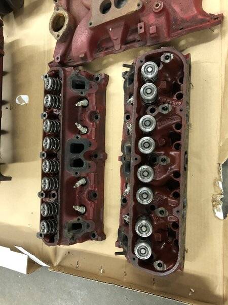

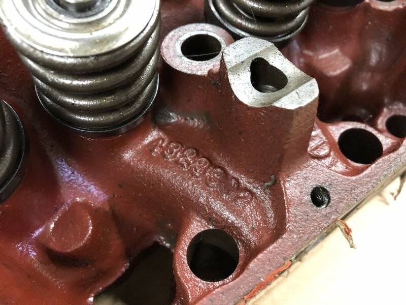

Look for a pair of 920's. Close to the 302's but no cracking issues that I have heard of. Smaller ports (273-318) and small closed chamber.

You either take a small chambered head for compression and port it to get the flow you need or you buy a small chambered aluminum head to get there. I get a charge out of the guys with a stock short block, pistons .060 in the hole and put a set of large open chamber 360 heads (for the flow) and throw in a big duration cam. The static compression is in the high 7's at best. Not the best combination
The heads he talking about are closed chamber that why he asking if his cr will now be too high for his cam since it's designed for 8.6:1.

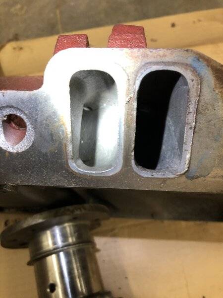

Yes I bought the cam when I planned on using a stock engine but the heads I have with it now have threads for the intake manifold that are jacked up and I tried to port match them to the RPM manifold, more like a taper not that it will do much with stock small sized valves.
So it looks like it will not boost it much? Is there anything I have to worry about as far as valve to piston clearance with the bigger valves?
check it with clay to be sure.
