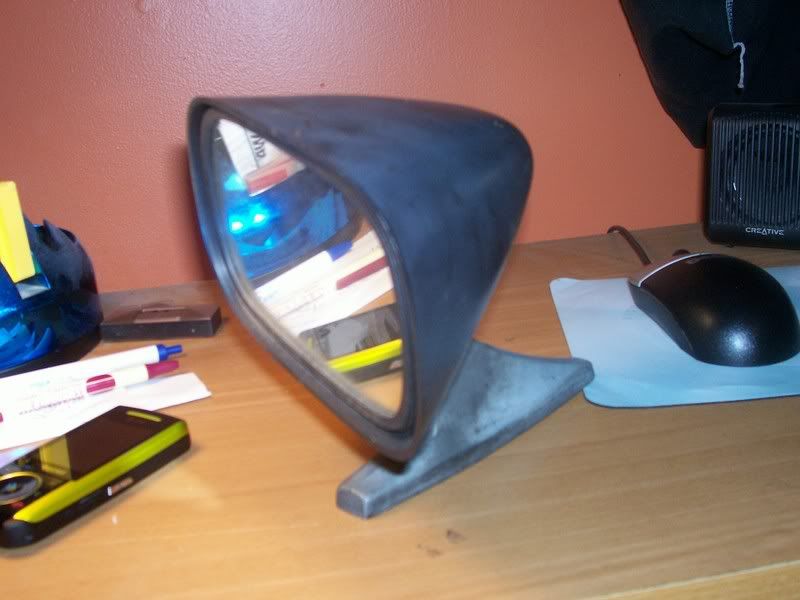

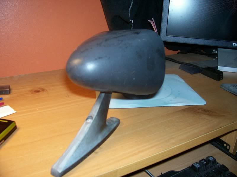

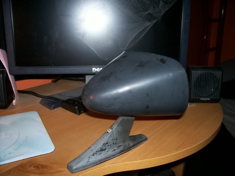

THESE are the mirrors that are on the car.......Both sides......ball swivel.....very thick plastic outers.........painted the color of the car...........The car also has no remote on the drivers door.........What say ye......? Stock? Repop? They are definitely not newer parts store repops.....maybe older, thicker, etc......but not Chinese.......
Definately aftermarket mirrors you have there. Vintage for sure, possibly American made. The 2 visable screws are a clue.

Those are Parts Store mirrors. Never factory original installed. Not strange at all to see cars with them. You see them a lot because they are a common replacement for pitted originals, broken remotes, or/and easy cheaper way of getting matching dual mirrors. I think you can still get them. Check JC Whitney. Maybe change them to all plastic now. But same basic design.

They're not JC Whitney mirrors...........at least not from any recent decade that I'm aware of, and nothing like them is currently offered.
Still kinda strange I think........they must have sold thousands and thousands of pairs of these things for us to come up with 4 cars now, in this short thread, that had them when we found the cars.........:read2:

factory mirriors? no way! those are cheap knock offs. what i mean is my car used to have those mirrors on it when i bought it in 05. someone put them on because the original drivers remote mirror was missing for what ever reason. in doing this they closed off the inside remote adjuster hole to make it look as though it never had a remote mirror on the drivers side. that is why i said to check to see that someone didn't do the same here with your car. i would think by 74 remote drivers side mirror would have been a standard item. maybe not though......still worth checking
also word to the wise those mirror hole from those mirrors will not line up correctly with the original rallye mirrors. i had to have the holes welded closed and redrilled correctly to reinstall the factory rallye mirrors. it was worth it though as those plastic mirrors were crap
Plastic mirrors like those and similar were sold by the thousands, probably millions by many manufacturers over several decades..:clock: They are not factory Mopar mirrors, but look good and function on a budget.
