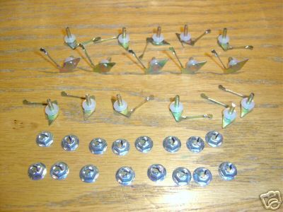

Is this the clips you are talking about? If so, I don't have any holes to fit these clips maybe the holes exist but it's either under bondo or welded over. I think it doesn't needs to be hard to locate this holes but i want to be sure first.
Those are only half of the clips you'll need for '73. Call RT Specialties. He doesnt advertise a kit for the swinger, but he has them in stock. I just received mine both those clips & the plastic clips came in the kit for I think it was $24. Good luck

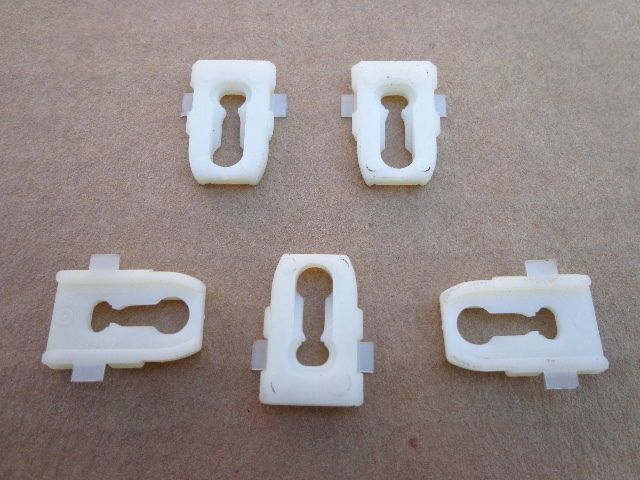

Is this clips the one for the vinyl top. Or is this quarter window molding clips?
