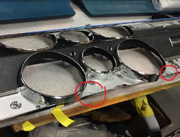

Dash dimples
They are sink marks in the molded plastic part. The plastic boss is likely much bigger in diameter than the nominal wall of the part that it protrudes off. Poor part design. When the plastic cools down, it shrinks and forms sink marks like you see here.
I'm trying to determine how upset I should be. If these marks are common, I might not be that upset. But if I'm the only one...

My 68 Barracuda dash has at least one dimple like that and it is the original. I have Deluxe interior with the burl-wood overlay on top so I don't really know how many are there.
My original bezels don't have any dimples at all. 67 & 68. None on the glove box pieces also. They are the only 2 I have in hand to make a comparison.

I think that is caused from over tightening the frame to bezel screws. I juts looked at 4 I have here and none are like that and the two installed in the cars aren't either.
What is the detail on the other side of the part, opposite the dimple?

I warn my customers to not over tighten those bezel to housing screws.
I have pics here that show outline of the housings perimeter in the plastic.
I'm guessing the dimples have been there a long time and only more visible due to new paint.
Can we make those dimples go away ? Maybe... Get some screws of same size and about 1.5 or 2 inches long. With the bezel alone, run the screws in to all the same depth/plane and let the bezel stand face up on the screw heads. Pile a few hundred dollars worth of hotrod magazines on top and let it lay for a couple weeks.
The dimples, along with often wavy brims are the pitfalls of restoring these plastic bezels. Owners naturally inspect their parts much closer after returned than they ever did before. They'll discover flaws that were always there, then complain to the restore vendor.
