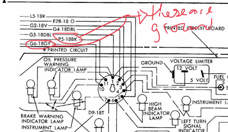

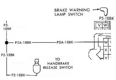

Here's a start (no pun intended).
1970 Plymouth FSM
Feed to the lamps is with the key in run (I1) -> J2 -> G5.
G6 ends up here with no splices.
So far, if the oil pressure warning lamp flashes during start - its likely to be a brief back feed through the ballast. Would think it unlikely that current can be sustained through start when there are other paths to ground available.
These are grounds. All the other lights in the dash work off the instrument cluster ground. The warning lights each have their own ground. Ie: when the brake distribution block loses pressure it complete the ground via the switch.
For sake of clarity in this discussion, now we know what you mean by grounds.
I don't call those grounds. To me they are a connecting wire and a ground wire is normally at zero voltage.
While I have in the past described that type of connecting wire as a return or ground when explaining the dome light switches, I refrain from that if I can.
The wires to the sending units are at system voltage when the key is in run and the switch is open. The wires between the dome light and the switches are hot all the time.
Is it important? IDK but it could be. Its kindof like a switch leg in residential wiring. Switch is off but the wire leading to it is hot and so is the fixture.
Only when current flows through the lamp does the voltage drop to zero on the return side.
